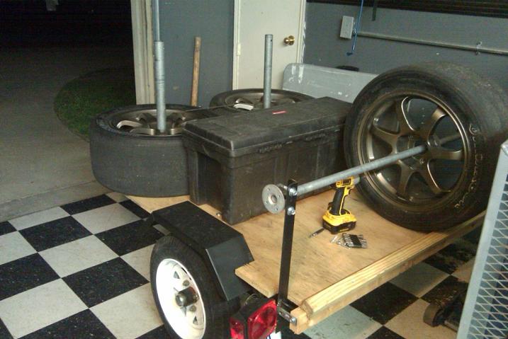

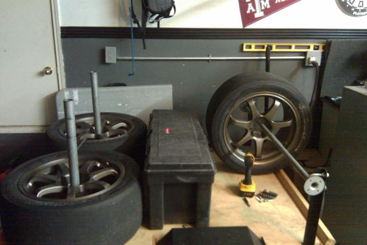

My AutoX trailer - HF trailer - 12 inch tires
This is my current trailer set up!
I have had to redo this thing a few times now and im still not sure if im happy with it, but here it is!
I will update Completed pictures when done......
BRAND: HARBOR FREIGHT KIT TRAILER 12 INCH WHEELS
PRICE: ABOUT $200 BUCKS
KIT: yes, had to hand assemble, nuts and bolts, no welding.
LIGHTS: Conventional lights - came with the trailer.
I am doing my trailer this way to keep 4 wheels mounted off the horizontal bar and tools in the center mounted tool box! You can also see that even though the trailer is 42 wide i used a 48 inch wide plywood top, so i got a bit more overhang out of the plywood to fit everything i needed by notching out around the fenders.......
I am also adding the two vertical poles up front "just in case" I need to take 4 more additional tires -- Usually for a drift event......
However, I do own an 18 foot car hauler trailer that I tow the Z and gear to drift events so that is very very rare for me to carry 8 tires on this little trailer. I like this configuration because I will most likely ONLY have the 4 tires on the rear for a local AutoX event and mount my eazy-up canopy across the front instead of carrying 4 more tires.......this also keeps tongue load lighter.....
HERE ARE PICS OF THE INITIAL SET UP:
Horizontal pole mount:
LINE-X THE 3/4" PLY WOOD:
803d9579.jpg?t=1273147371
9446e469.jpg?t=1273147765
I will post completed pics when im done.
IN the works -
1. I'm currently gonna have the 3/4 inch plywood line-X covered so that i wont have to deal with paint, stain or changing the plywood ever again.
2. Also thinking of either rubberize coating the metal frame or taking it to get powdercoated....
3. Going to foam wrap the poles to keep down the noise and damage, nicks, etc to the wheels..........meh.....
-J

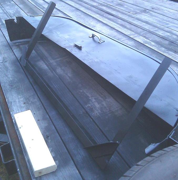

BRAND: CraigsList PORTOPOTTY TRAILER (48 inches wide)
PRICE: $60 bucks - Delivered
KIT: No assembly required except wood frame and wiring. Some welding was required for the back (cost 30 bucks)
LIGHTS: Harbor Freight 19.99 special with AUTOZONE LED connectors
COMPLETED I can get 8 wheels on this bad boy and I plan adding a toolbox eventually and something to hold my mini generator as well.
I will post better pics if I can find some...this all I have for now..

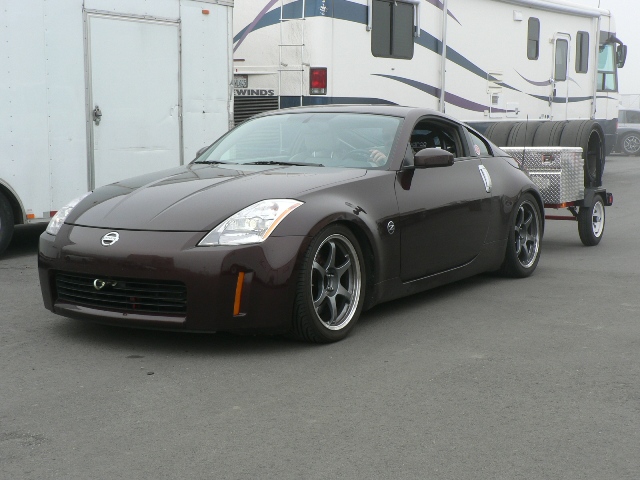

BRAND: Lowe's (3.5x5ft)
PRICE: $420
LIGHTS: No assembly required
On some scales - allowed me to position the tires to get just right load on the hitch (~50lbs):
Aluminum Box (Harbor Freight). Built in lock and lid shocks:
Rails to hold the tires - I bought the magnets (black brick looking things) at Harbor Freight (250lb pulling EACH) and attached them to the bars. That way I can position the tires back-forth whenever I want without drilling etc. These stop the tires rolling when driving, and a racket strap on top stops them going up and down.
Magnets:
Finished product:
PRICE: $420
Magnets:
Finished product:

My Trailer
I designed the layout and had the wheel carrier fabed onto the trailer. I addaed the storage box. I used this trailer for four years and just sold it when I made my car a trailer queen. Total cost $700.

i'd like to thank jason for an awesome hitch, awesome work, great service, and fast shipping!
stayed up all night working on a few cars and my z...
still gotta finish the wiring
will be picking up an scca/autox prepped trailer later.... pics coming

picked up the trailer ealier today...
snapped a few fancy shots
before the event sunday, i should be adding type of railing or a-frame so i can fit 6 drift wheels on there...or maybe 4; keep 2 in the car...
