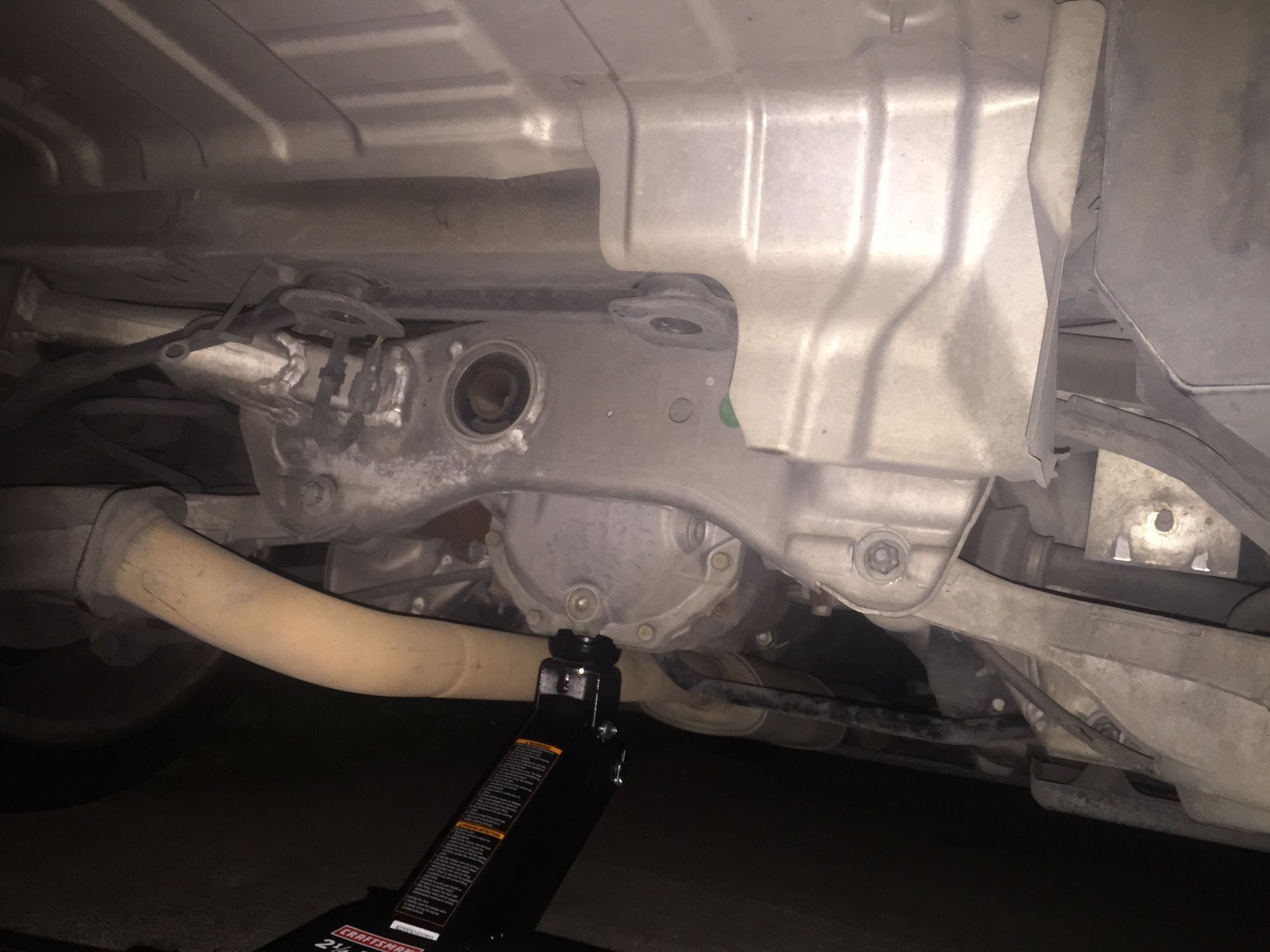

Im trying to just get a temporary fix until i can save enough to replace the rear suspension

Jack the car up - and grab some pictures for us =]

I'll post them in about 2 hours

What year is your car? I will go ebay and get a used rear sub frame and have body shop to install it.

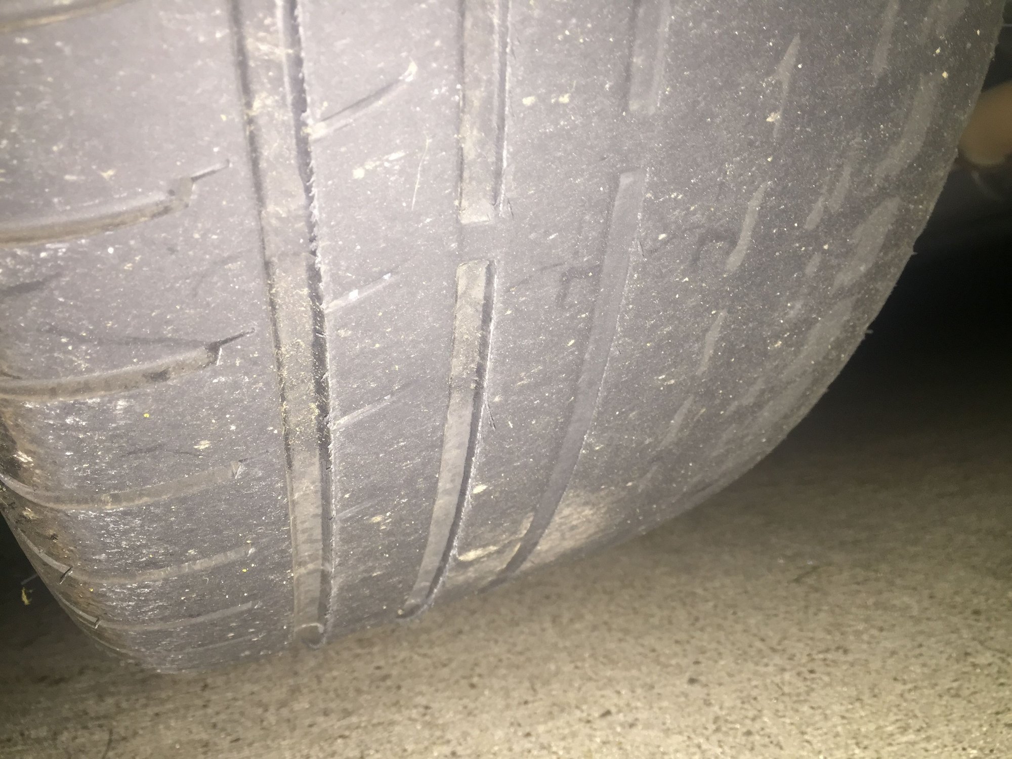

Jesus fk. Get some new tires.
Pay attention, kids: This is called buying above your limits. "Looking for a temporary fix."
But hey, who cares? Pullin' mad bishes with that dope whip bruh!

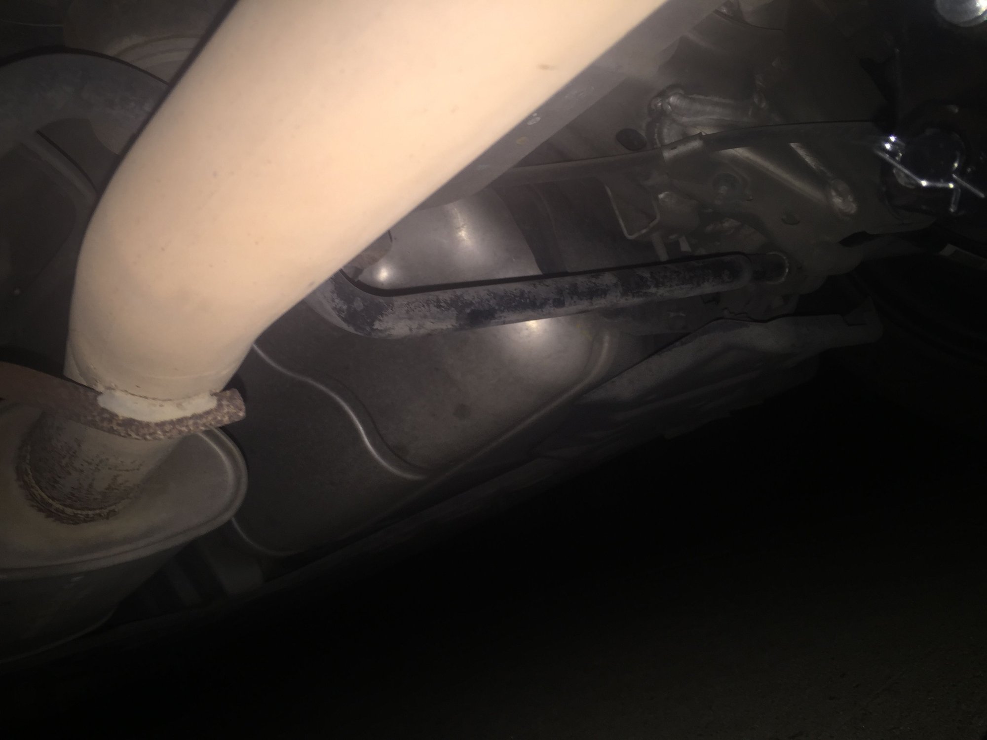

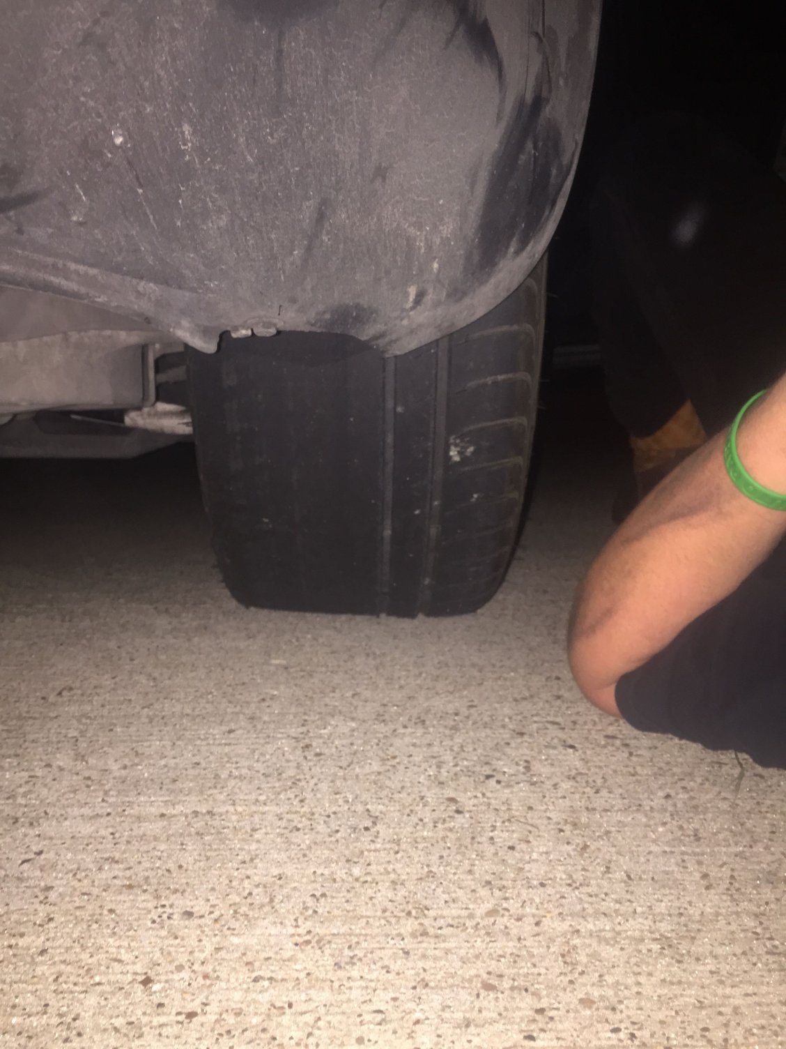

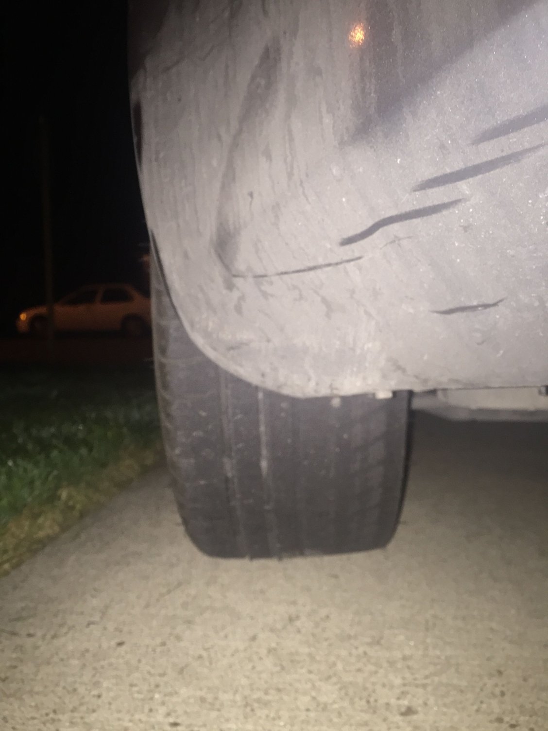

looks like you tire is rubbing on your rear bumper cover check your traction rod bushings.

I bought the rear tires a week and a half ago and they wore down while I went from shop to shop trying to get a good quote. It is insured but I didn't want to go through insurance and I had only removed the muffler to get some better pictures of the suspension and I don't ever drift this car, I had spun out while coming out of neighborhood unintentionally and since I hadn't ever drifted a car I really didn't know what to do as far as getting it straight again. It's a shitty situation but it happened and I'm trying to just figure out the problem and fix it.

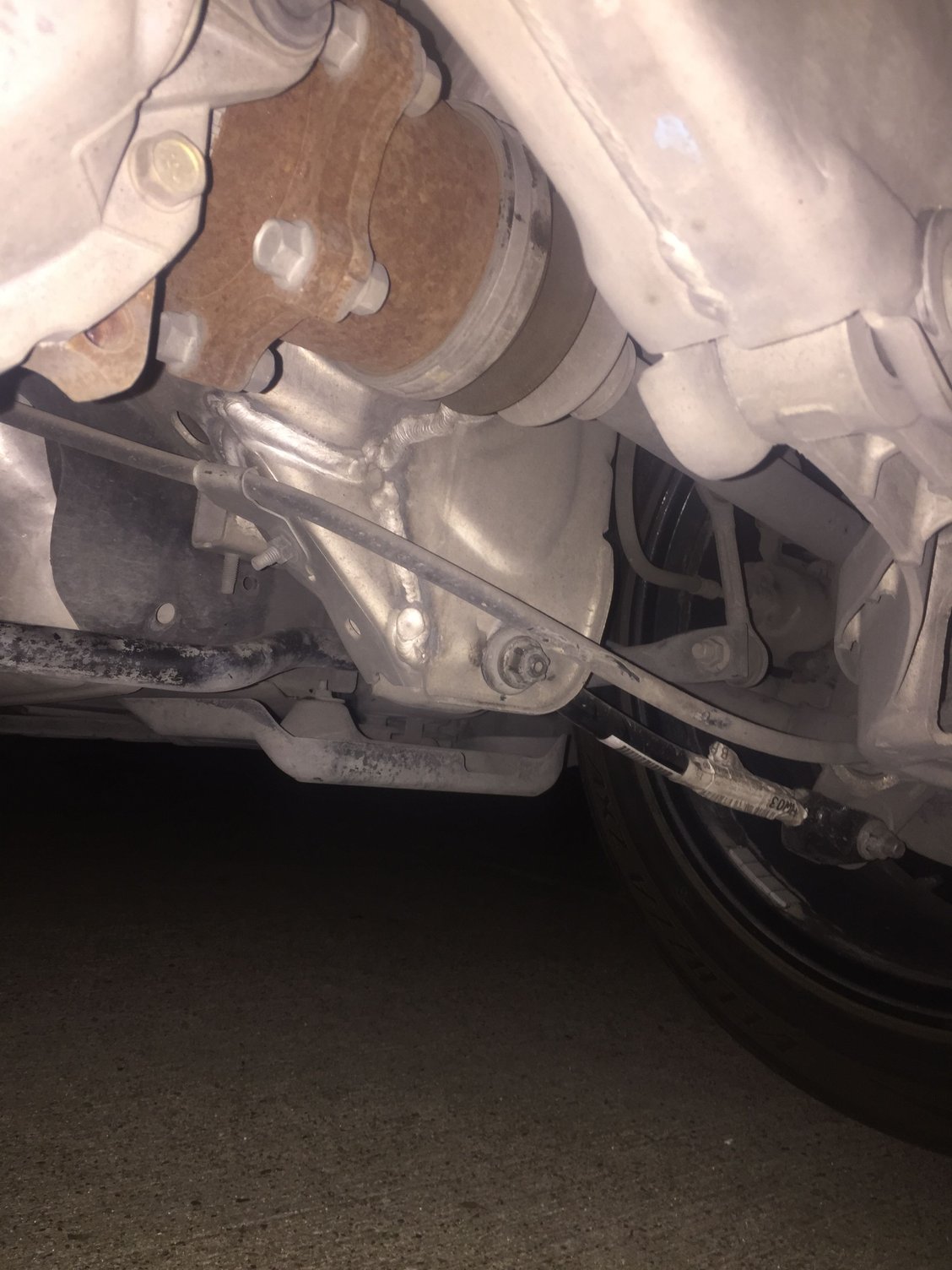

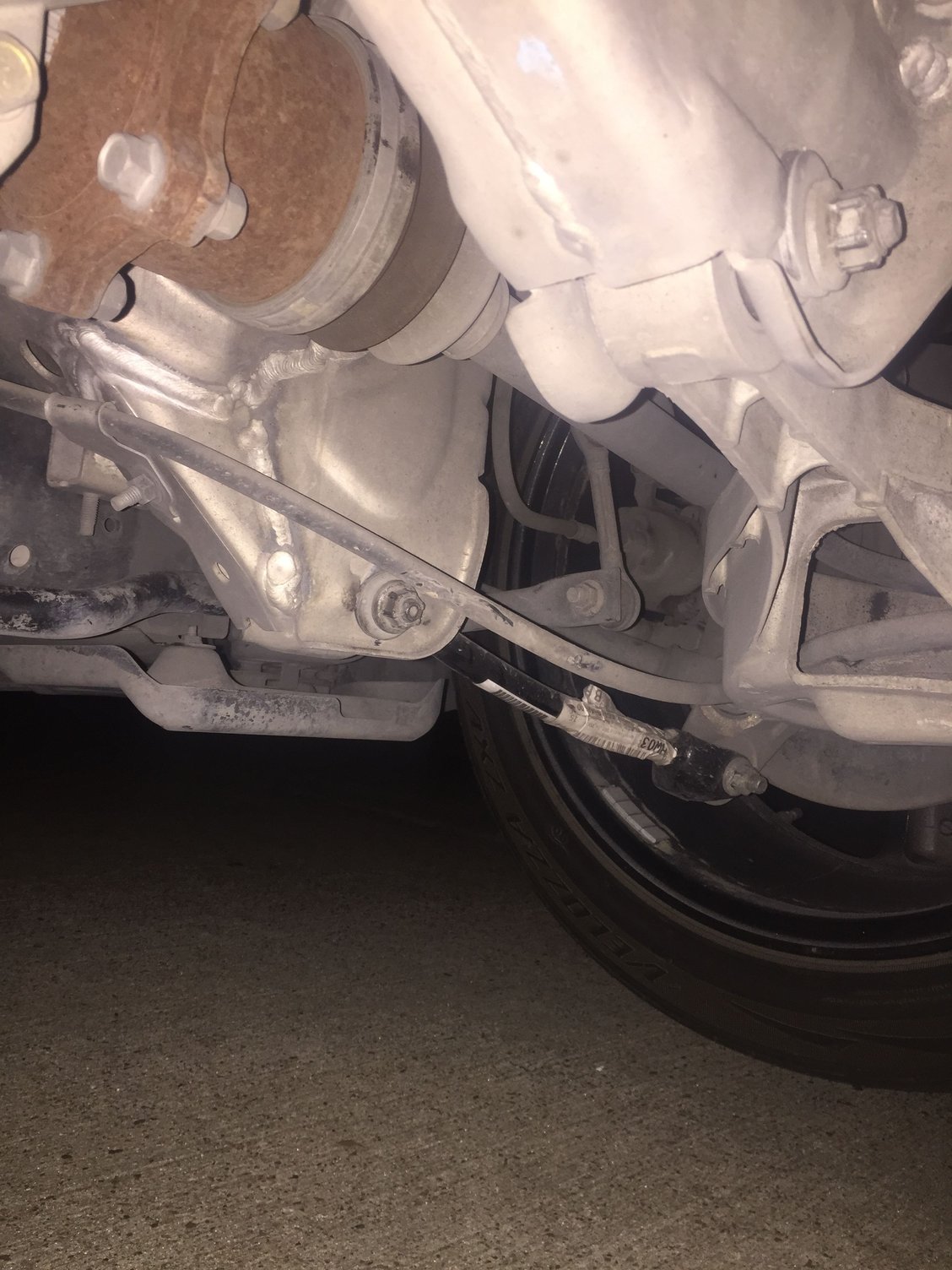

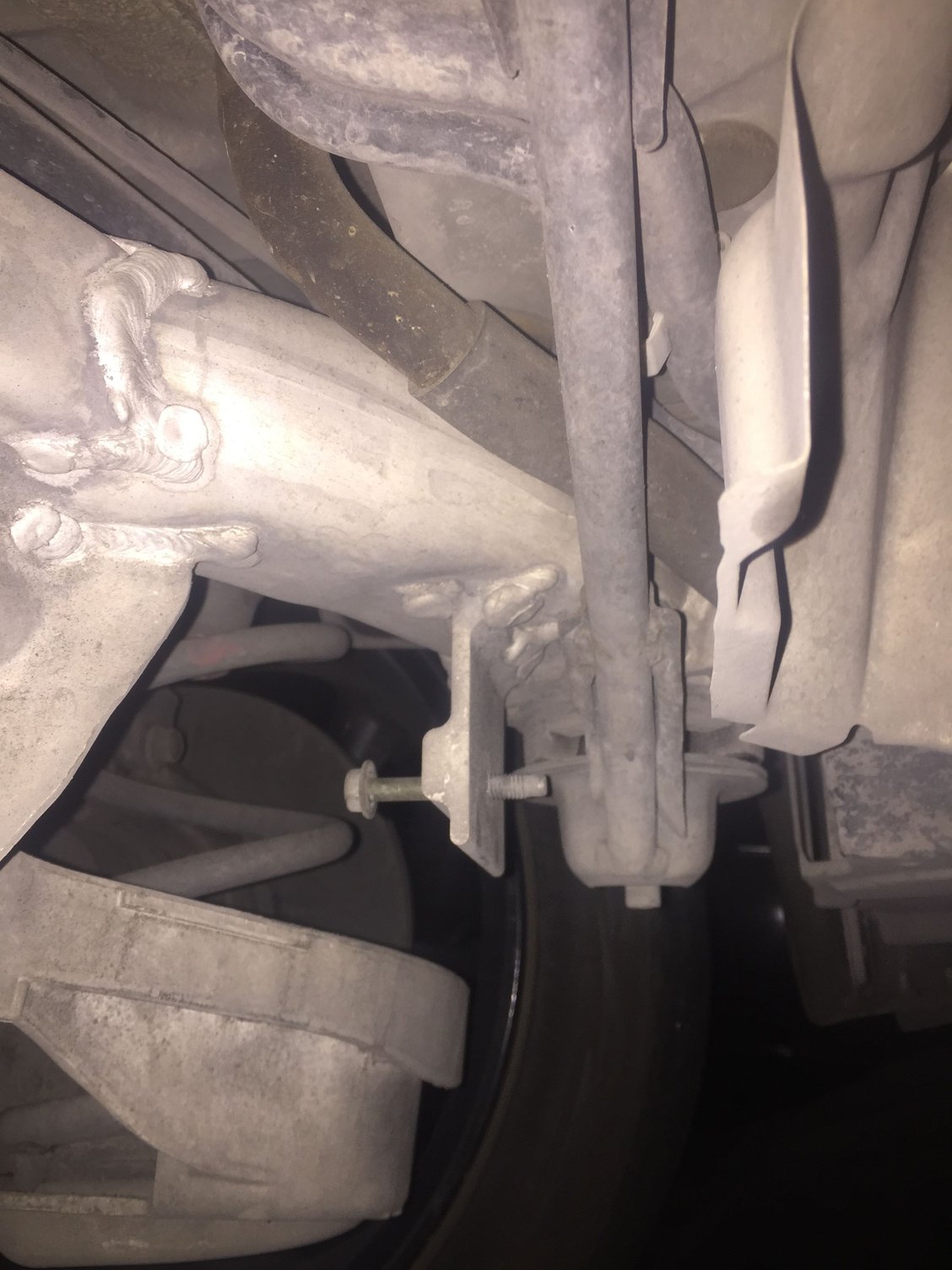

The subframe is obviously damaged in the pics. Look at how the metal overlaps in your third pic down. Look on craigslist for someone parting one out and see if you can get that subframe, assuming its not damaged. Try to find a front hit.
When you get it back together, go find a parking lot and practice losing control until you're comfortable regaining it. Remember CPR: Correct, pause, recover. Most people spin out the opposite direction because they overcorrect. Get to know your new car before you drive it hard.
The "overlapped seam" is welded like that and looks identical on both sides in the pics...
Old 04-10-2015, 05:37 PM
kilogram
kilogram's Avatar
Join Date: Sep 2013
Location: Arvada, CO
Posts: 233
Received 10 Likes on 7 Posts
You're right, that does seem to be normal. There's still damage though if it can't be aligned. I'm surprised an alignment shop isn't measuring the mounting points to verify it's straight. It doesn't take a lot to bend aluminum suspension components.
