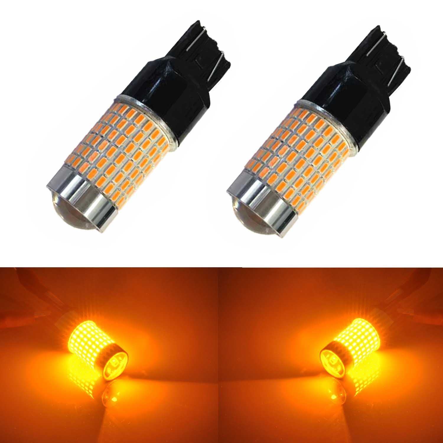

I bought some of these and painted the inside black:
And installed LED's like these:
https://www.amazon.com/gp/product/B0...?ie=UTF8&psc=1

Can you put those LED bulbs in a normal light, or does the light have to be made for LEDs?

They're plug and play in the reverse lights, but if you put them in the signals you need to add load resistors to avoid "hyperflashing". Something like this:
https://www.superbrightleds.com/more...rning-fix/190/
