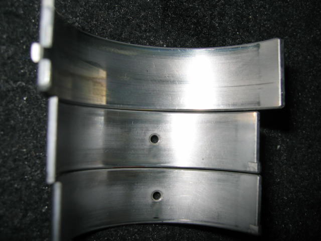

This is something I said when I first did the tear down of my 8lb Stillen SC motor with 3k on the ODO
The attached photo shows how the rod bearings were being "pounded" at the center of the cap and main rod body mainly due to rod stretch while over reving or possibly oil related issues.

Peter, I agree with your thoughts. My engine held up to a lot of power and abuse for a long time... had I seen the stock internals before hand, I would have pushed it even harder... but at that point I was listening to all the things everyone else was saying about how bad the stock rods are.
Upon taking apart my engine, I noticed the rods to be pretty damn good for a stock rod... the rod bolts a little small, but HP doesnt really break a rod bolt... thats RPM.
There was only one part of my internals that even looked PARTIALLY worn after all that abuse (not only was it making the proven power, but I drive the thing like i stole it... flooring it at every light, burnouts, donuts, street racing, long duration high speed)... was the top shell rod bearing.
It was the only worn part at all... Matter of fact, why dont I go take a little picture... BRB.

Thanks for the pic Charles, very interesting, by the way how many miles had that engine done before you stripped the engine?
