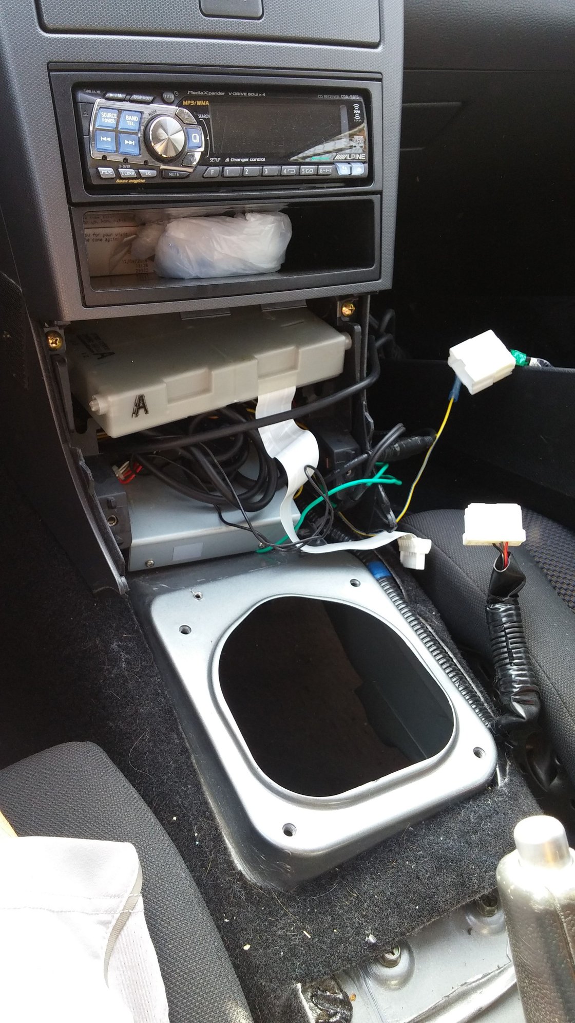

I have a 03 Enthusiast with 61k original miles. Pretty low mileage for an old vehicle. I've purchased this vehicle used (an older gentleman used to own this).
I've never had any issues with the transmission EXCEPT there are times when I would grind shifting into 5th. The grind felt very minor, and it only happened very rarely and only when I'd go on a spirited driving. No grinds on downshifting. Only shifting to 5th.
Last night, around 3A.M, i was on a ramp going onto the freeway. No hard shifting or anything, just a casual, smooth shifting through each gear (at around 2.5k RPM). Then when I shifted onto 5th gear, I heard & felt a gnarly grind. I put the gear into neutral and let the vehicle glide. Then I've rev matched into 5th (no grind, smooth shifting), and gave a little bit of gas, but only my RPM would rise.
I was surely in 5th gear, but the vehicle didn't respond. It felt like I was in neutral. I shifted into 6th (abnormally smooth), and still felt as if I was in neutral. Then I downshifted to 4th, and the gear *caught. I drove through the freeway in 4th gear the entire way...
I got off the freeway, and my gears from 1st to 4th worked just fine. Except when I shifted onto 5th gear, the vehicle acted as if I was in neutral. When I got in front of my house (with vehicle still on and clutch fully engaged) I played with my gears a little bit. I was scared and confused why my 5th and 6th gears wouldn't catch.. and when I put the gear onto 5th, I felt a firm, snug feeling on the tranny. Unfortunately, the gear successfully went into 5th, but it won't disengage.. I turned my vehicle off and tried to pop it out, but it's literally stuck on 5th gear.. I've tried fully engaging the clutch, but no luck.
Now I have to start my vehicle in 5th, and drive in 5th... (I've only driven from the parking lot into my garage).
I've been searching through my350z forums for solutions.. I've seen "toasted tranny," "bad synchro," "shifter linkage," etc..
I'll probably take the vehicle to a shop 1st thing tomorrow.. But if any of you 350z masters out there could give me any clues.. I'd really appreciate it.. Thank you guys..
P.S: I'm going to attach a photo of the shifter stuck in gear..It may not look like it's stuck on 5th, but it is.. It's literally impossible to pop it out.

Do you have your stock gear shift lever? You might try to re-install that. I can't tell if you have a lot of grease on the ball or if something is broken.

Sorry, I don't understand what you mean by stock shifter lever.. Do you mean the shifter itself? If that's what you are referring to, yes it is stock.. Everything on my vehicle is stock on Engine & tranny.

PS: KornerCarver, it's the grease on the ball.

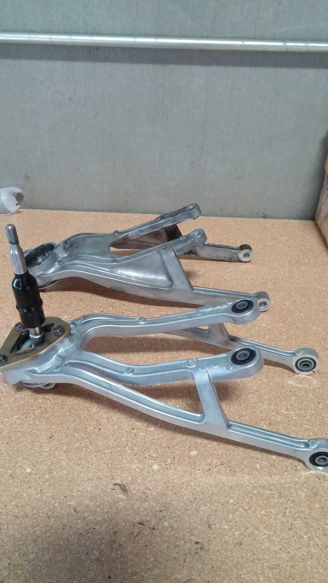

SO, i did confirm with Nissan once again thru VIN that the tranny model that i have is 32010-CD00A which actually supercedes CD009. Woah I'm excited!! as far as the clutch disc goes, i was informed by Nissan that I won't need a separate clutch disc because I actually purchased a new clutch for my car.. (fx stage 4 clutch - let the bashing begin)
Oh and yes.. because I purchased a CD00A and I HAVE CD001, the shifter bracket does NOT fit. I did read the CD001 shifter bracket being tad bit wide and longer. I wasn't able to take pictures of the holes don't matching, but I did take a few pix of the shifter bracket... (I contacted the guy I purchased the tranny from.. he said he actually MIGHT having it laying around somewhere. I'm hoping he finds it!!)
- So for future references, or anyone who reads this thread, remember, when you are UPGRADING your transmission from CDxxx to CD009 or CD00A, YOU WILL NEED SHIFTER BRACKET THAT ACCOMODATES CD009 AND CD00A.

Just ordered a new shifter bracket that fits CD00A.. Got it from a 3rd party parts dealer (selling oem). Total came out to be about $130 with shipping. Because of its scarcity, I was told that the part will arrive to their warehouse in about 3-4 days and THEN it'll be shipped to me. So I'm expecting this item to be in my possession within a week or so.. Pretty excited!

So I've finally received the shifter bracket! It took a while.. but not cheaper than buying from Nissan! (It's still OEM part). I'm excited to drop it off tomorrow morning.. and have it installed!!!!! CAN'T WAIT TO SEE MY BABY AGAIN!!
*A few days back I dropped by at the shop and took a few pix of my baby.. T.T
Soon I will be able to post pix of my baby running!!!!!!!!!! EXCITED!!!
i feel empty..
top: old shifter bracket from Cd001<br/><br/>bottom: new shifter bracket for Cd00A (tad bit lighter)
Shifter swapped! took about 2 min to do so. VERY VERY excited to have it mounted!
