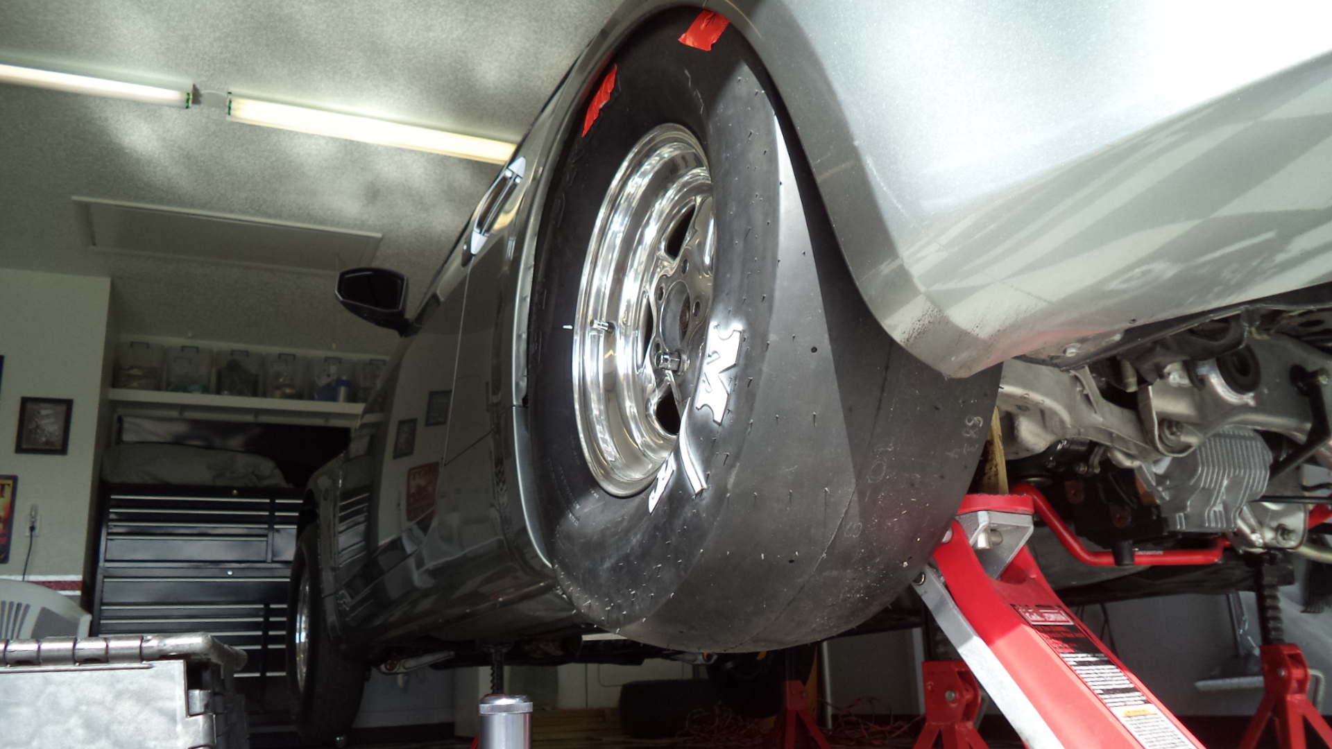

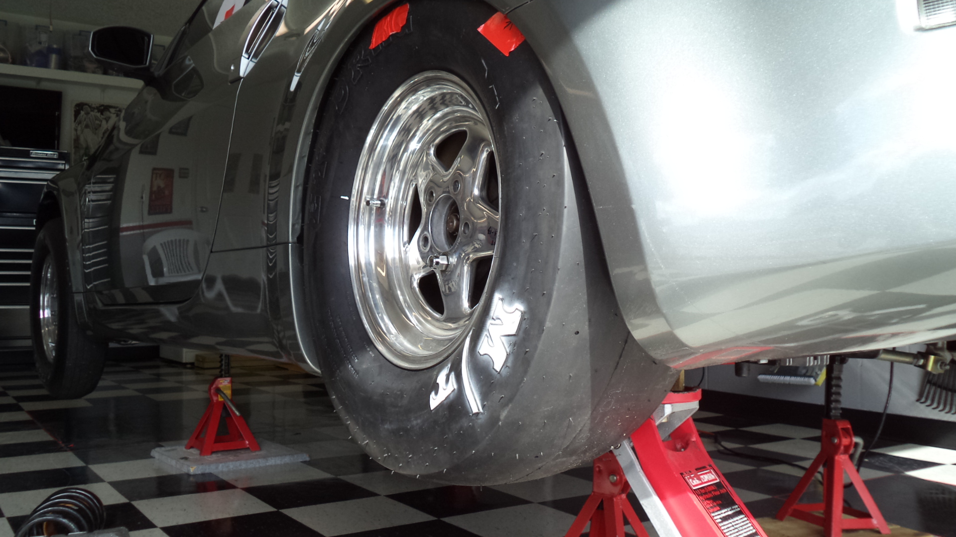

Oldman, I have read it around here before, but cannot find it again. What is your wheel/tire setup?
Old 03-15-2016, 05:04 PM
  #46
OldManZ350
OldManZ350's Avatar
Join Date: Nov 2003
Location: Florida
Posts: 2,407
Received 228 Likes on 168 Posts
Rear MT 28 x 10.5 x15 (3055S)
Front MT 27.5 x 4.5 x 15 (3009)
On weld Prostar wheels
Old 03-15-2016, 05:16 PM
  #47
Jaxter
Jaxter's Avatar
Join Date: May 2012
Location: NW Houston
Posts: 303
Received 0 Likes on 0 Posts
Thank you. Do you remember the offsets, or have you tweaked it with adapters?
Old 03-15-2016, 05:22 PM
  #48
OldManZ350
OldManZ350's Avatar
Join Date: Nov 2003
Location: Florida
Posts: 2,407
rears are 15 x 8 with a 5.5 B.S.
Fornts are 15 x 4 with a 2.75 B.S. also has a 1/4" thicks spacer and longer lugs to clear rotors.
Hope this helps,
TimRod
Old 03-15-2016, 05:40 PM
  #49
Jaxter
Jaxter's Avatar
Join Date: May 2012
Posts: 303
It helps a lot. Thank you very much.
Old 09-15-2016, 02:44 PM
  #50
TT03Z
TT03Z's Avatar
Join Date: Jul 2016
Location: Omaha
Posts: 327
Received 31 Likes on 27 Posts
Hey I'm curious if you had to do any grinding on suspension or brake parts for this wheel/tire setup? I'm going try and tuck the same size tire and wheel. My car currently has big brakes front and rear so I'm sure I'll have to find a set of stock brakes to run and I'm also guessing the fenders are rolled?
Old 09-15-2016, 04:55 PM
  #51
OldManZ350
OldManZ350's Avatar
Join Date: Nov 2003
Location: Florida
Posts: 2,407
I did not roll the rear fenders, I trimmed the sheet metal back a little. About 1/4 to 3/8"..
other than that it all fits great.

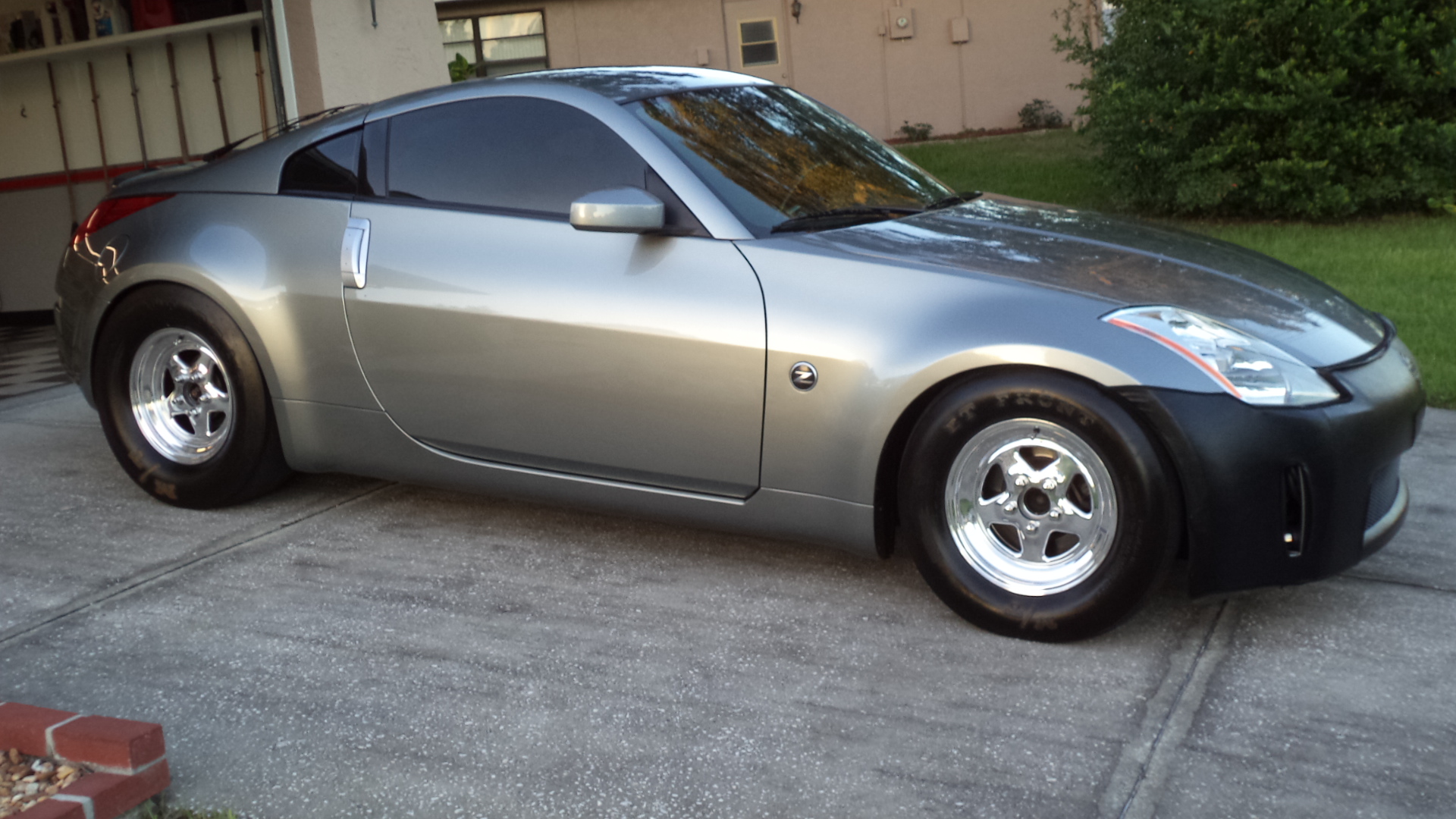

Pictures
Attached Thumbnails New Stock record and new personal Best-dsc00090.jpg   New Stock record and new personal Best-dsc00091.jpg   New Stock record and new personal Best-dsc00094.jpg   New Stock record and new personal Best-dsc00367.jpg
