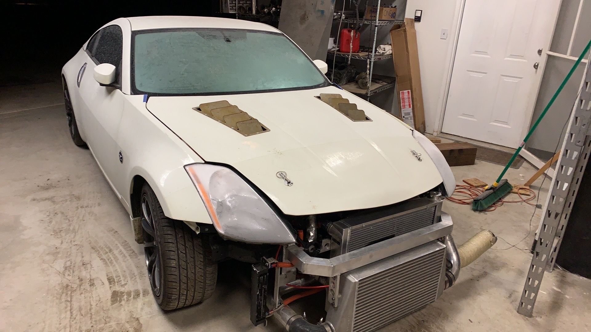

fabricated them myself … found a guy with a 2D plasma cutting table …
had a conversation with DPhoenix and he said look into Alumalite … which is a composite aluminum/plastic core that many others are using for underbody. Its roughly 1/3rd the weight. Not too bad at $200 for a 4'x8' sheet will probably need 3 sheets and I may stick with aluminum sheet on the rear of the car. We'll see.

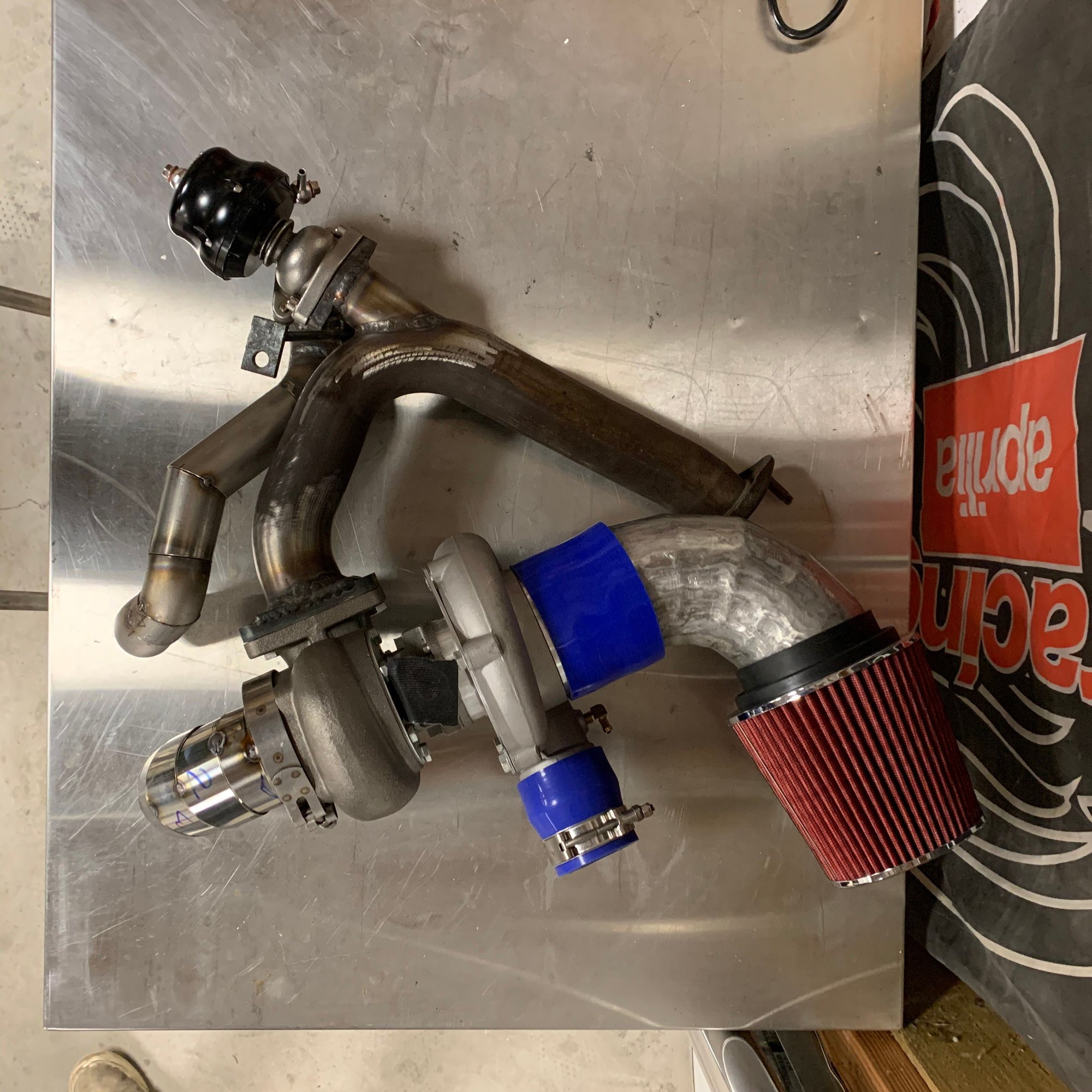

ahhhhh ... good times ... got the car out last night and tonight annnnnndddddd ... just parked it in the drive (to work on my buddy Reilly's car). Temps are still pretty cold and when I got put it back in the garage it was slicked over with ice. But good lord, for how cold it is, the car cranks for a second and starts (I'm still loving the Link).
making strides on the rear-mount turbo ... interesting setup all things considered and maybe not the 'exact' way I'd do a rear-mount setup but none-the-less things are coming together.
