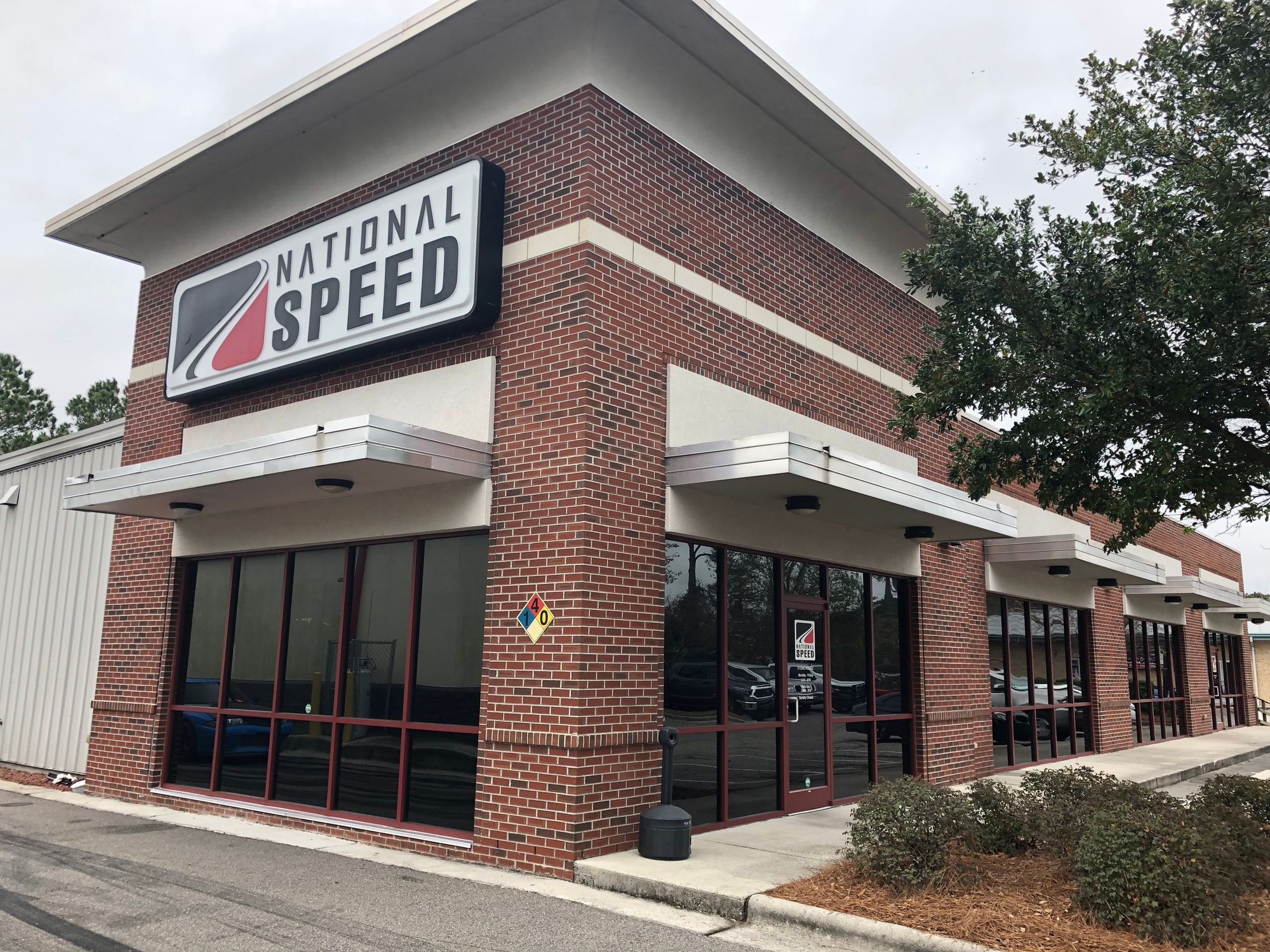

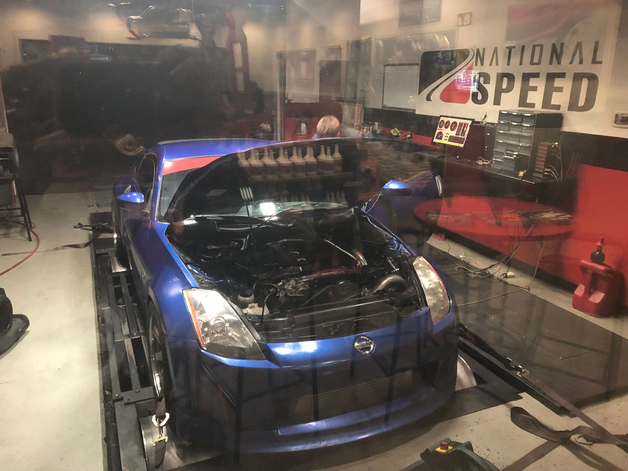

Arrived at National Speed a few hrs ago. Very cool facility here with well-knowledgable employees. Vlad is starting with his own base map with the PMAS maf sensor instead of the GT Maf just in case we run out of resolution. Main concern is spark blowout and fueling, if there is blowout, ive given them the ok to regap the plugs and continue. Hoping for the best.

Well bad news, While Vlad was taking care of the fuel trims my cog belt snapped in half, and i failed to bring an extra with me. I paid for the time i spent here but will need to return to finish the tune on the 31st, good news is that i wont be needing to wait long, i will be pullying down to the 2.87 pulley as well, Vlad said i am not spinning the blower hard enough.
I will type up a thorough responce later, getting rdy for the 3 hr drive back home. All is not lost, i am staying on course!

Yea i know Aboodi was fighting with belts with his Z as well. The YSi is a hard, harsh blower to spin. V8 guys all use 8 rib or even 10 rib pulleys for max durability and grip. And since im still on 6 rib for now, i will be fighting this alot more.
So to summerize, there was 8 total pulls. All with low timing, and All the runs were short, only revving up to 4-4800rpm. Light and partial load was finished beforehand.
i was almost at 400whp just before 5k rpm on run 6 of 8. Mind you this is with Vlad still making fuel adjustments only and low low timing, and with 2100 more rpm to spare! So i am happy about that. Once timing is advanced, more power will be made especially with e85 helping.
Glad i went with no expectations. Now its just a matter of fixing my weak areas on this car and head back for round 2! 👍
