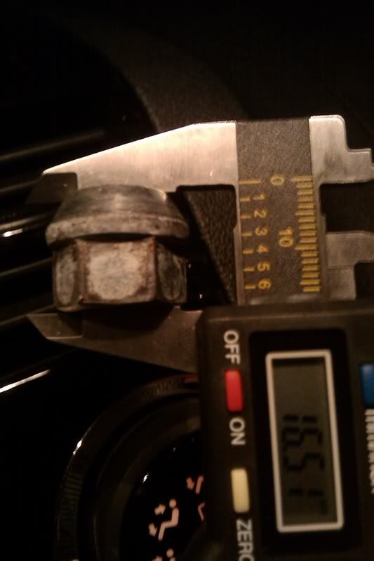

Default 7 - Thread protrusion on spacers!
Ok, this example:
Shown are 20mm project kic spacers. We are definitely going to have thread protrusion and NEED "gaps" between the lug mounting wheels on our wheels of choice for this application.
Measured of a 20mm spacer:
Digital Calipers used - HF ~ 15 bucks....
OEM stud measurement PAST the spacer thickness:
-J

aside from gorilla that are 21mm tall(.825) i have found these that are 16.5mm tall:
I like to use these lug nuts.....they use a 17mm hex socket to install them and are M12x1.25 of course.
They are 16.5mm tall:
