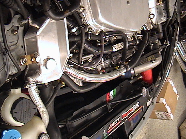

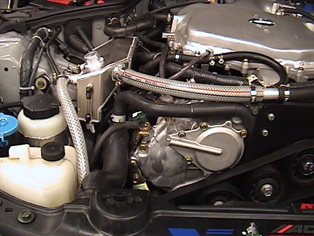

Here is mine with Vortech, AAM/ARC
Attached Thumbnails I need a catch-can, but am undecided on which one, need pics-nissan-picts.-063.jpg   I need a catch-can, but am undecided on which one, need pics-nissan-picts.-066.jpg

the ARC one is a catch can - they advertise it as such - it's most definitely not an overflow can of any sort as it installs to the crankcase vent "nipples" on either side of the motor.
Inside I've never seen it but as I recall from talking to one of the "sans" from ARC it's baffled internally. But I have it in my car and is has trapped the small amount of residue I'd expect from an NA car with my mileage. I believe AAM caps the top vent ports and welds a nipple to the can that then connects pre turbo.
As for the Cusco and Greddy types, they work just fine in fact. If you vent one end to atmosphere, it does not need any medium sitting inside (at least none from what I've found and I've used them on many of my own cars going back to the mid 90's). If you decide to make it a fully closed loop system, then adding some steel wool to the inside is recommended, or you can simply drain it at every oil change (I've run them both ways in my own cars)
