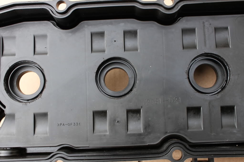

6- NOW YOU WILL BE ABLE TO POP OUT THE OLD O-RING GROMMET OUT OF THE VALVE COVER. PLEASE REPEAT 6 TIMES.
7- THIS IS WHAT IT WOULD LOOK LIKE WITH THE O-RING GROMMET OUT
