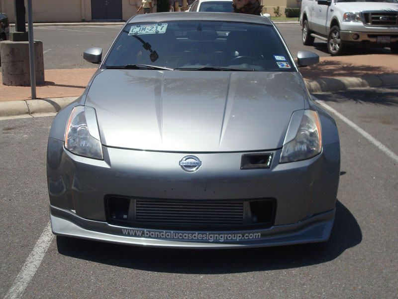

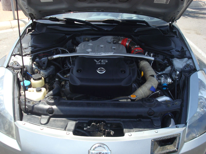

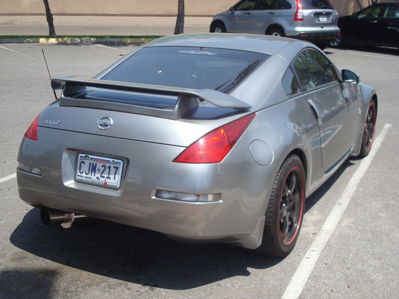

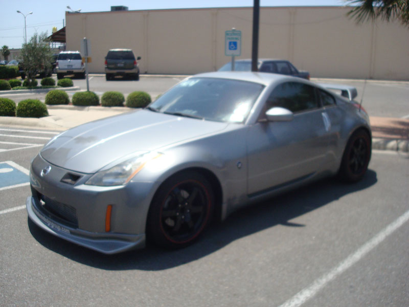

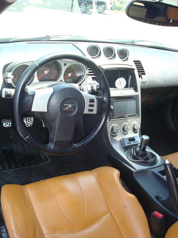

Default pics of my setup now
here are some pics of my ride i havent updated it in a while under my profile
