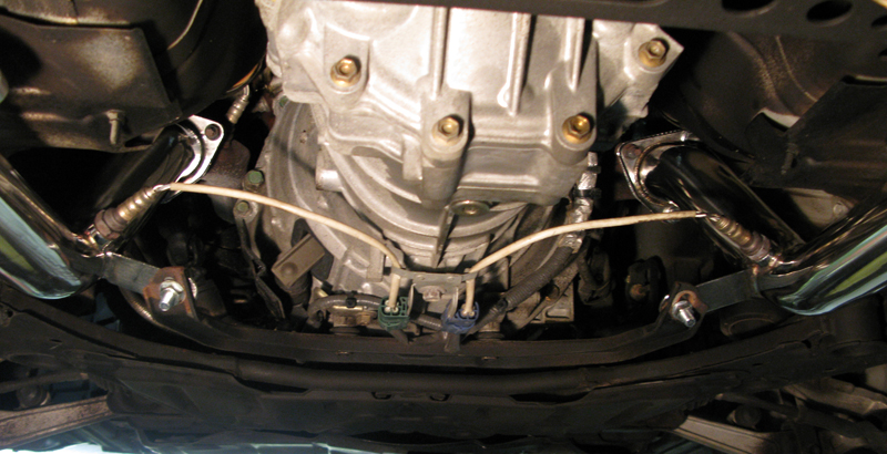

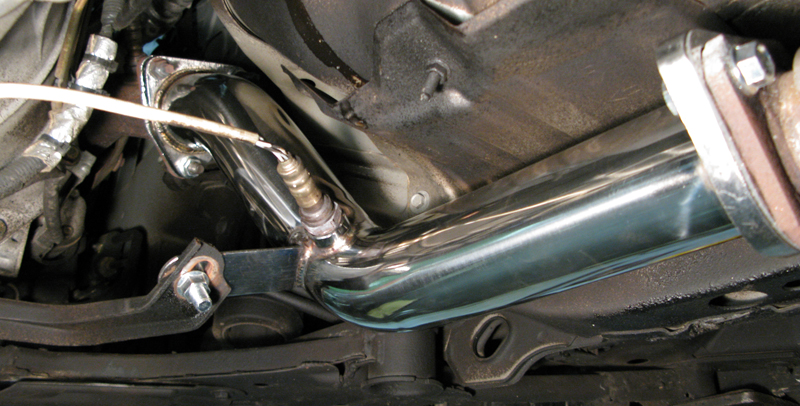

Originally Posted by nothix
just remove the bracket from the car and dont bolt them down, you dont need a special test pipe
Are you talking about this bracket?
Got the pics from "Novesh" Thanks
Attached Thumbnails Helix V2 cracked on me...need help pls-testpipes-bracket.jpg   Helix V2 cracked on me...need help pls-testpipes-bracket-2.jpg
yeh thats what hes talking about. my titek tp's cracked from that bracket.
So don't put that center bracket? Whats it for anyways?

^ that helps reduce your hfc or converter weights, but for testpipe, you don't really need them, because tp is so light.
yup thats the one.
Comes off very easily
