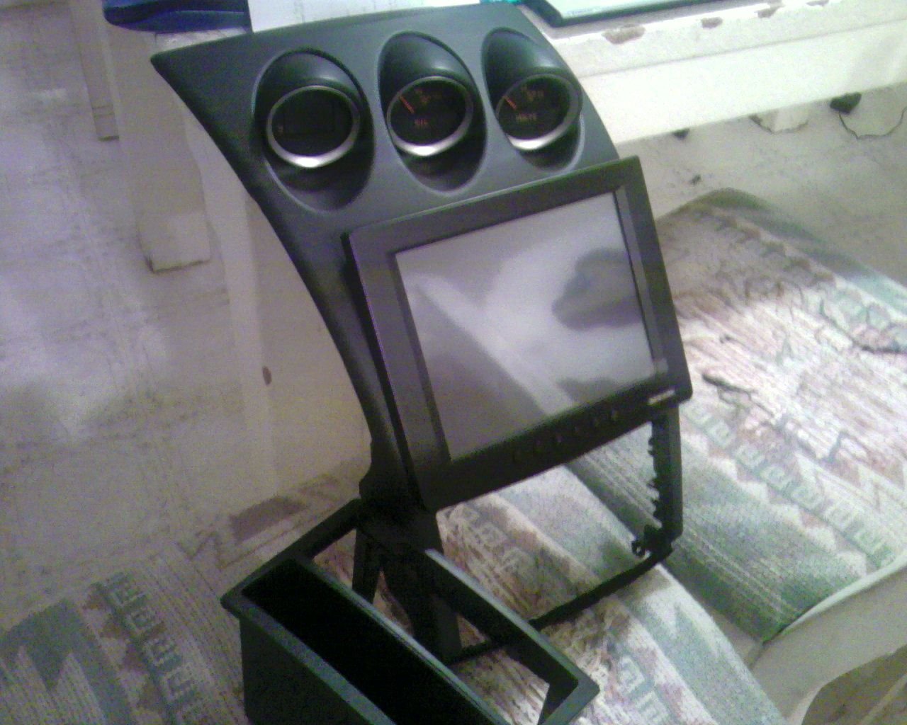

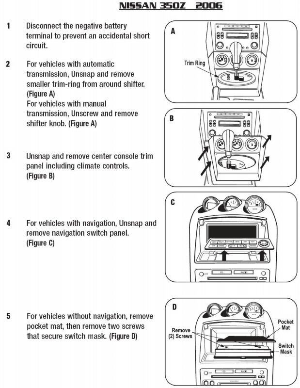

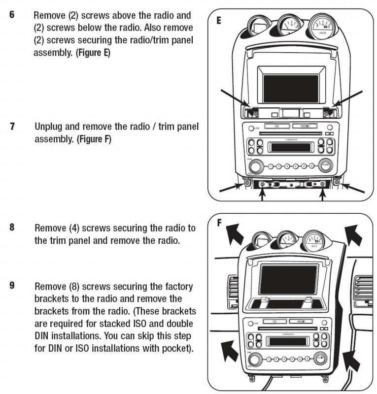

Reminded me of when my 20 year old Z was about a year old. My version allows for changing different computers since 19 years have lapsed from initial build.
https://l33tzor.com/radioinstall/

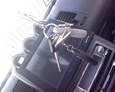

The Zenarc touch screen is 8 inches but at that year it was not the usual deal. Zs and other cars didnt have android car or apple which tepoaces the need of a carputer. A
Most cars have rear view when you place a car in reverse. I had tapped into the wire that sources the electric for the backup lights to turn on the DIY security cam I fitted so the touch screen gave me a rearview cam solution.
I probably can think of other things but senior moments is the blame.l33tzor dot com is still up or ig isnt used much and this firum should notify me if somebody has a question id live to offer some expertise on yhe matter as I had a small z and g forum with over 22000 posts but i quit the club stuff because of immature members and drama.
