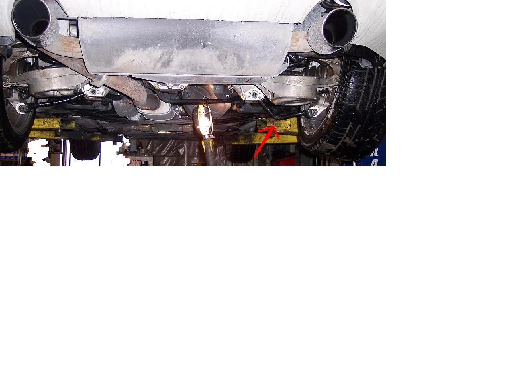

i was going around 80k on the highway and lost my backend out of nowhere. could recover and hit the curb on the passenger side.
I wonder how much this is gunna cost me.

Yep, looks ike the stock OEM Shitenzas'
SNOW TIRES, especially that far North. GL with your repair, chalk it up as a lesson learned.

Yeach look at all the dried salt!!
Your spring cradel dookickeys look different...

Looks like the right side is screwed up. Can you post any other pics?

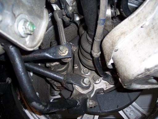

more pics

I would replace that bent camber arm and then go to the alignment machine to see if everything else check out alright. Aftermarket camber arms run around $100 to $175 each. I can't see from the picture whether you damaged anything else.
Looks like a DIY from what I see, but, I can't see much from the photos you posted. Check the connections to the chassis...hopefully, none of them are bent.
