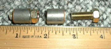

Anyways...Both rear tires are on the front and I think they hitting/ rubbing something and that's what causing the shaking...(it feels and sounds like I have a flat tire). Do you think this could have caused any major damages? I haven' t driven the car yet but I'm debating on driving it the 15 minutes back to the dealership...
Anyways, think twice before you take your car to Performance nissan!
Don't drive it.
Call the dealer, tell them exactly how they screwed it up and DEMAND a flatbed to come and pick it up.
Vova, That pin is suppose to keep the rear wheels from mounting on the front hubs according to the manual. Supposedly the rear wheels don't have the hole for the pin to fit inside.
I don't doubt that the pin is to prevent this from happening but if you remove it the rotor won't shoot off or anything. It's just a screw. If someone could remove two different sized tires and rotate them and ignore then fact that it has a directonal rotation on them them removing the screw would be he least of my worries.

The alignment bolt is actually on the front rotor, you would need to remove the wheel to see it, however, since the wheels are in the wrong place you will be doing this anyway.
The backpad of the front wheel is hollow between the lug nuts, the rear wheel is solid. This bolt is situated on the rotor face between 2 of the lug studs, protruding out. This is the pair I removed from my car when changing the wheels.
