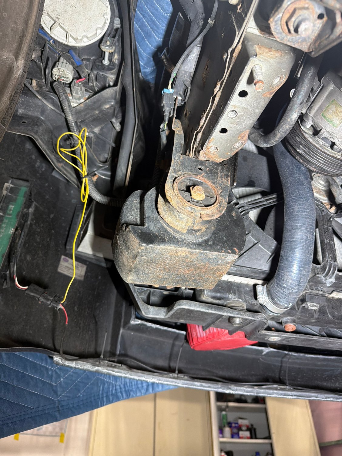

Originally Posted by SenseMotorsport
Is it ok to remove that big iron counter weight in front of the driver side front wheel, I just took it off and it weight about 22 lb. Will that creat any problem by taking it off. BTW I have a 04 roadster.
It has one in the trunk too, mine has the rubbers cracked, I can’t find parts to replace it
