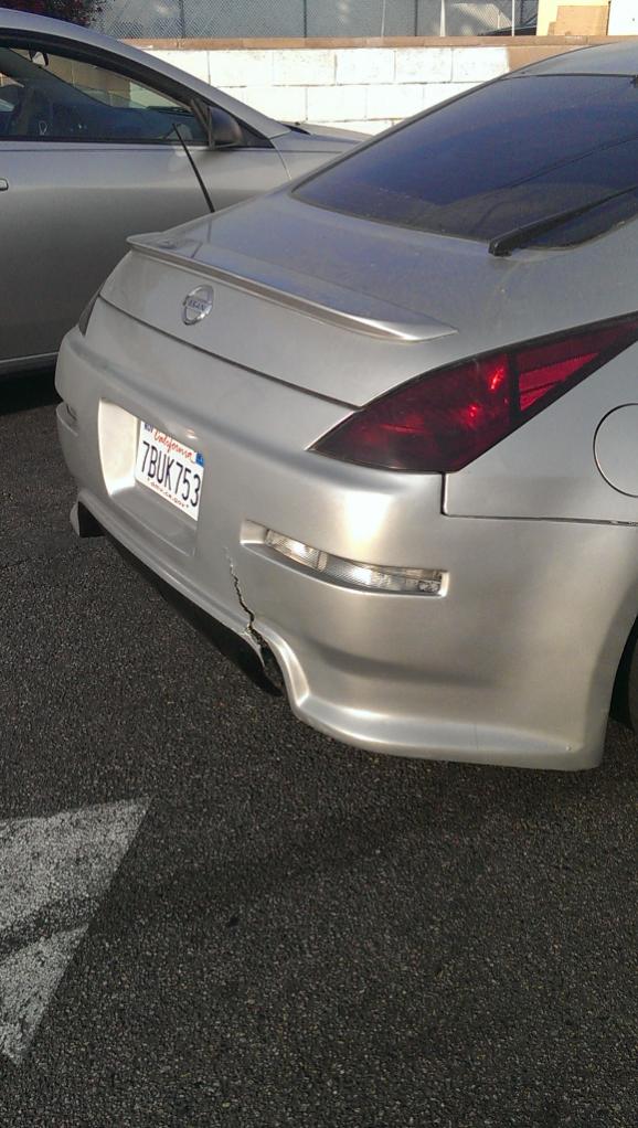

The crack got bigger
What's up with people doing those butterfly or X shaped fixes with the zipties

Been trying to figure that one out myself. Don't know why you just wouldn't get it repaired the correct way.

Just zip tie or safety wire stitch it for now, it will keep the crap from spreading.

I have one in the same spot from clipping a tire wall lol. I'm only going to get more so I will zip tie. So Who cares just stop the cancer from spreading. Fix it or replace during off seasons.

Get a cheaply fiberglass kit and patch it from the inside. It won't look as bad and you won't have the look of zipties

+1....good idea, then add clear touch up so paint doesn't Chip/flake off

Our bumpers are made out of plastic. there is a how to thread on here that shows you how to repair them
But you practically melt and sand the bumper back togeather.
Never zip tie if you dont have to or its an emergency

Zip ties are used mostly in the drifting crowd. Why? Because it only costs a tiny bit of change, and they don't worry about fixing it properly, as it's probably gonna happen again.
For a street car that's just daily driven... get it repaired the correct way.

just ziptie it or clue it as a temp fix...
we've seen worse...not thread worthy
