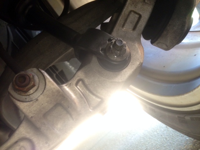

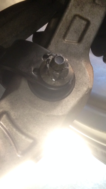

This is what it looks like

What were you using on that bolt? It looks like you were using a pair of pliers.
after it was stripped I used the bolt grips and that's why the nut looks all deformed
