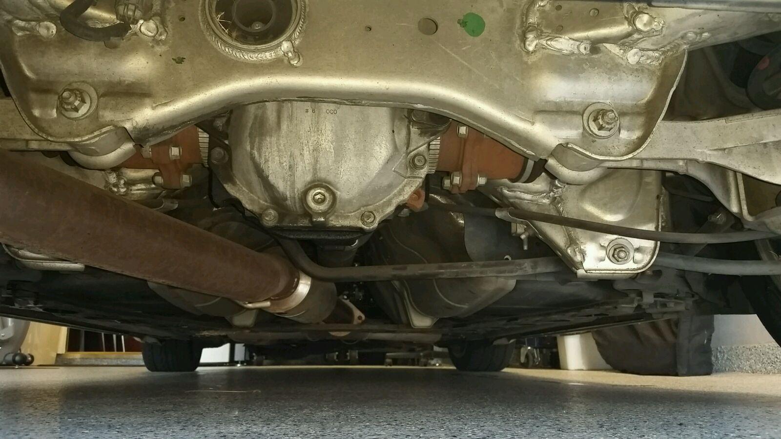

UPDATE: You guys missed that my rear diff bushing appears to be dumping silicone all over the cover lol. Also Apparently 07-08 clutch slave likes to go out and stick the pedal to the floor out of nowhere?
Leaky diff bushing is a universal Z issue, link to cure: http://www.whiteline.com.au/product_..._number=KDT911
"Newest" solution to slave issue, developed by a highly reputable Z aftermarket company: http://www.z1motorsports.com/350_g35...oducts_id=7340
