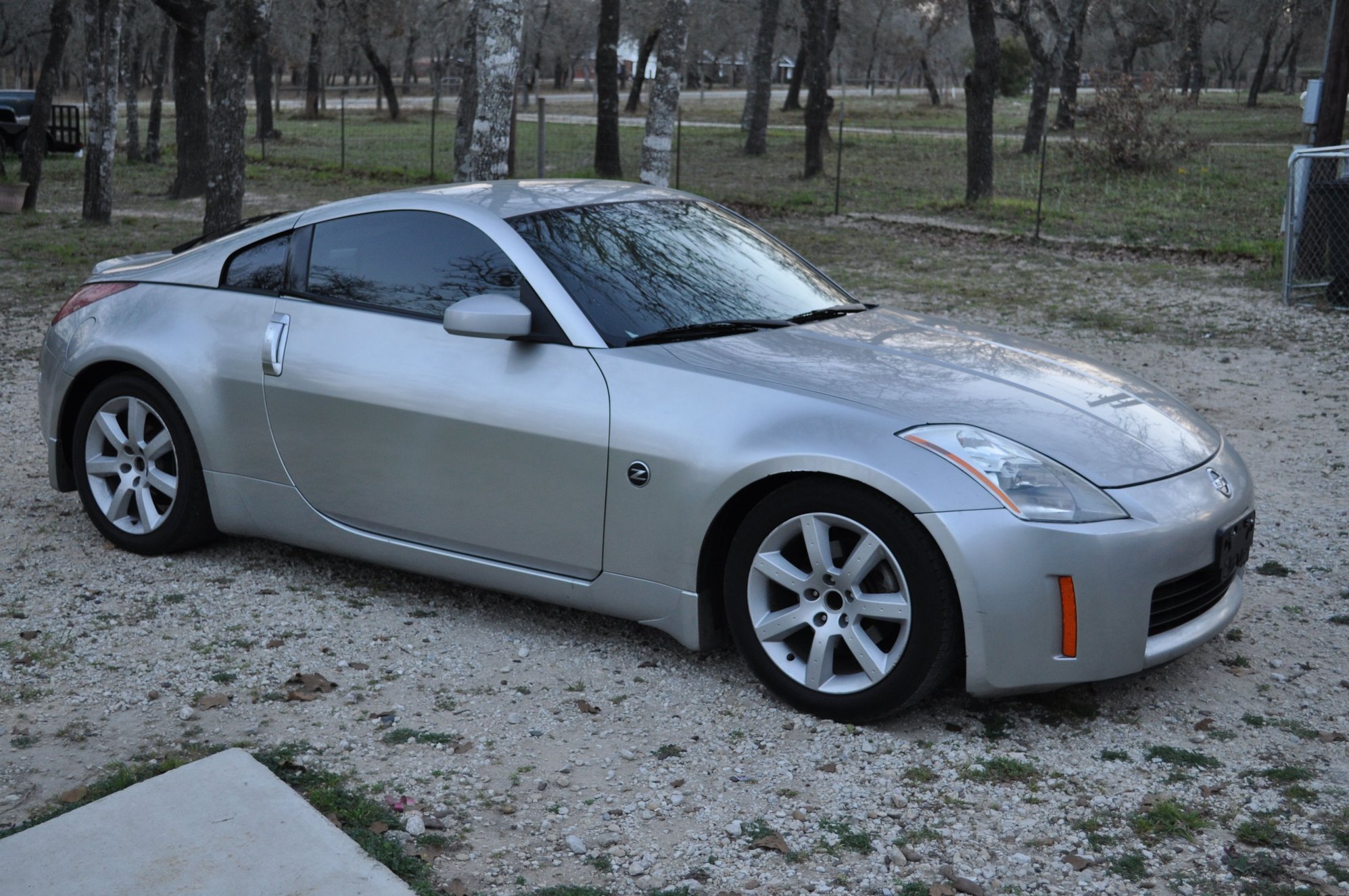

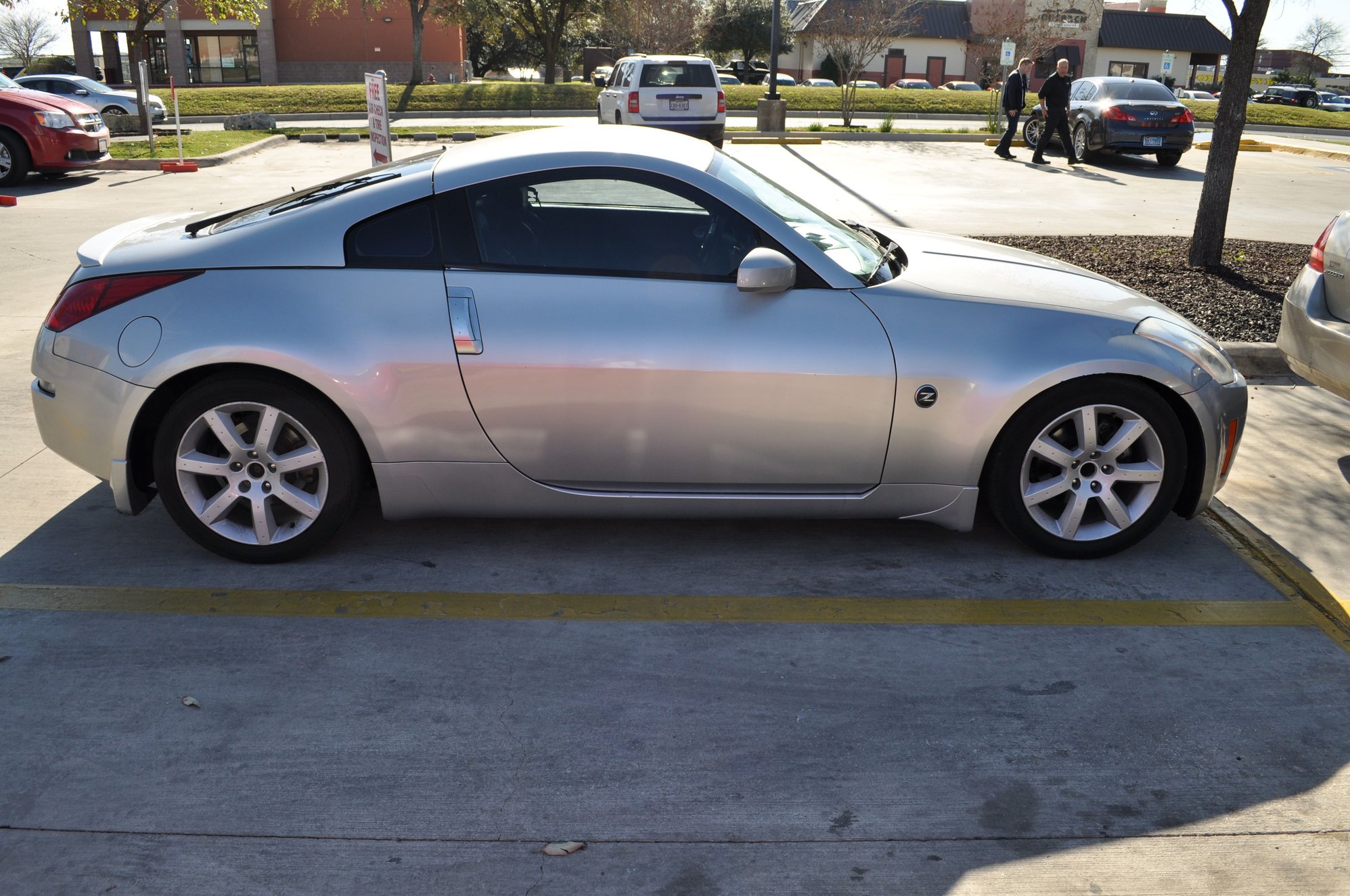

Here is the car when I bought it:

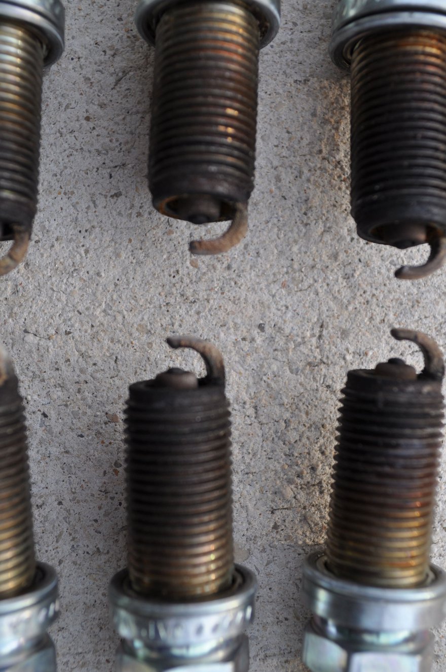

I pulled the first coil pack, inspected it for blisters, and metered it. All good. Pulled first spark plug....there was my problem. All six looked the same.
Sorry for blurry second pic. I was trying to get in close.
The plugs were shot! Looked like they'd been bad for the last 30,000 miles. That explained why the car bogged down with increased throttle. The spark gap was far to weak to burn a reasonable amount of fuel.

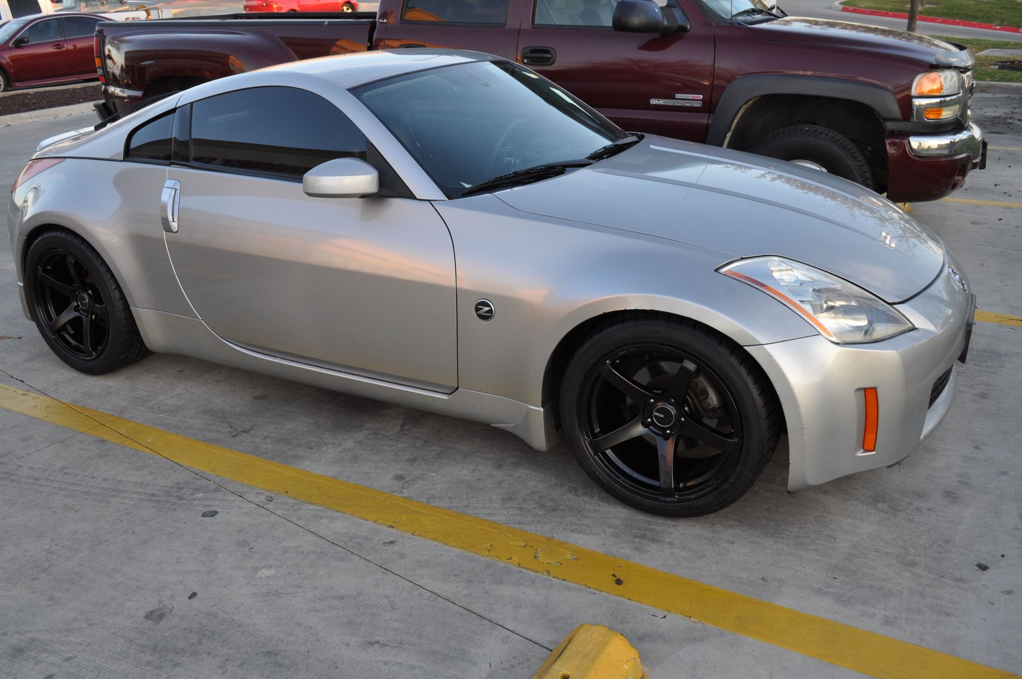

Enter the Enkei Tuning series. Specifically the Kojin Black model. The rims are 18x9.5, with 15mm offset on all four corners. The rear got wrapped in 275/40, and front got 255/40. BF Goodrich G-force Sport Comp-2 rubber. Here are some before and after shots:
The tires are dead flush on the rear. Looks very good. I'll be rolling the fenders tomorrow, now that I have a heat gun. Huge improvement, and the car hooks up now, unless there's some side load.
