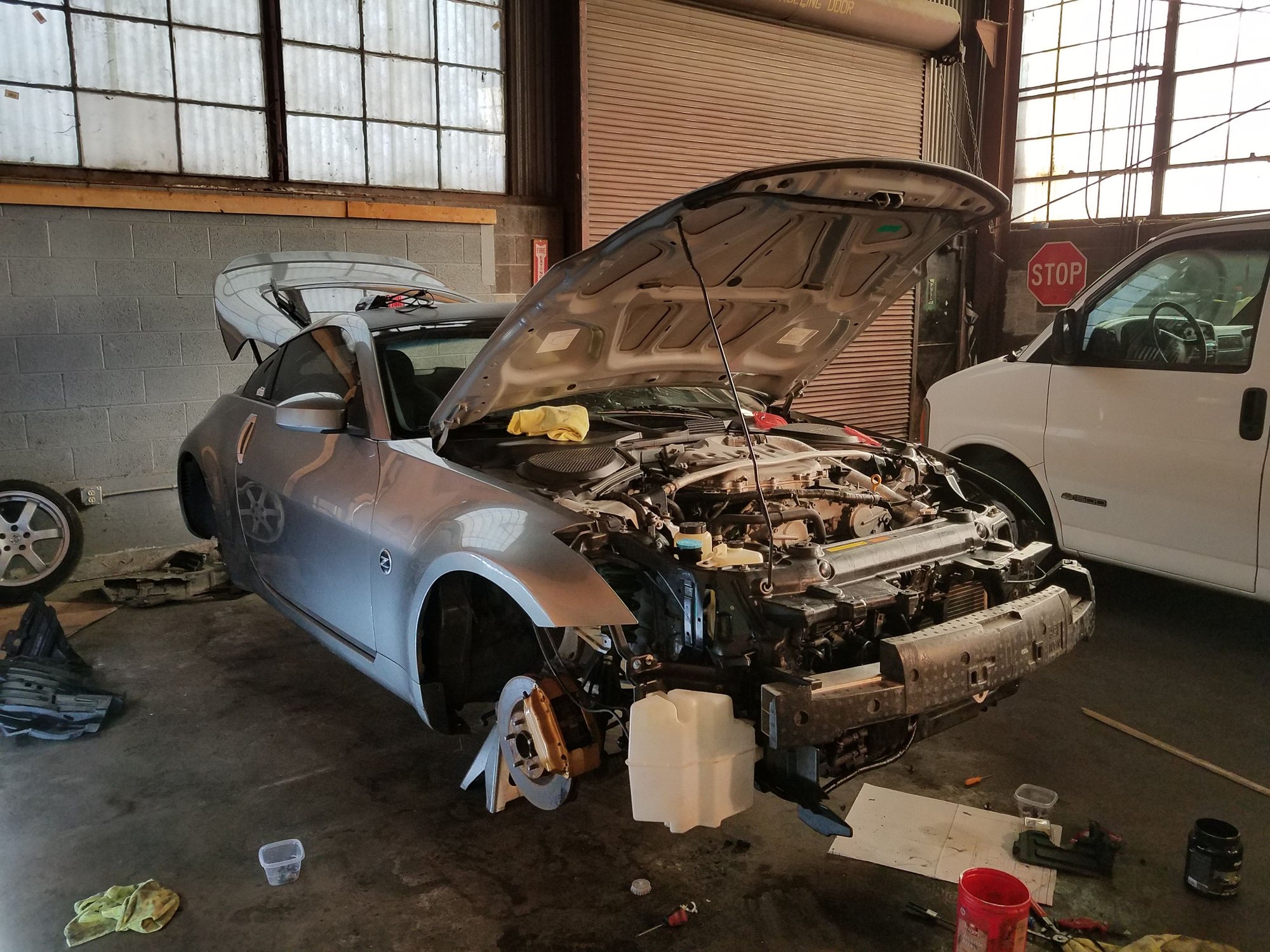

And I am fine with that. I don't post on here really ay all, but my friends are getting tired of me sharing updates about my car.
I bought my car knowing it was far from perfect, but I enjoy the challenge. Ever since I bought the car my life has been a wild ride (Stitches, lost a friend, broken bones, trying to start my own shop, hit a coyote with the car, and more)
. Any how, I have finally gotten to work on it. I started with repairing the coyote damage, cleaning, adjusting, and making everything perfect. I've started tiddy'ing up the interior, & this week end I am pulling the trans.
