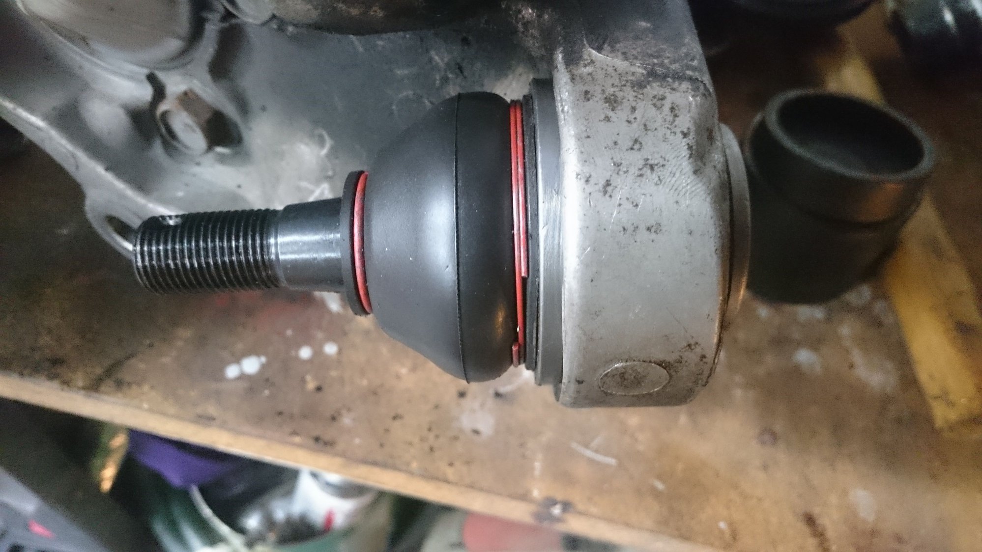

Anyway, I went with MAS XL ball joints. They seem very good and solid with a nice boot and clip to hold it. They're also about $25 each shipped. But I had a problem with the cone - as you can see in the last picture. It's too small in diameter or too tall, whichever way you want to look at it. I made it work by adding a washer that was larger in diameter than the top of the cone and thicker than the protruding length of the cone. I've been back and forth with MAS about it and it's definitely the "right one" according to the listing for my 03-04. So not entirely sure what's up. Aside from that, I like them a lot.
