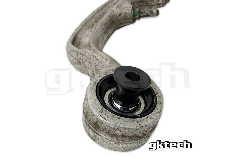

just wanted to update this thread. I ended up finding the cause of the popping/clunk noise up in the front suspension. It was the ball joints on the compression rods that were done. The ball joints looked in good condition the boots were intact and the ball joints did not have play. I was trying to save a few bucks by just replacing the bushings with the spherical bearing but I should've just got new compression rods and put the new bearings on those. Oh well lesson learned. Suspension nice and quiet now. Car even drives smoother.

so i had only replaced that on the old compression rod thinking the ball joints on it were got. So i ended up just slapping on some brand new MOOG compression rods

Ahhh, Ok. So you had gktech solid compression rod bushings. So the ball joints you installed are MOOG or did you replace the gktech compression rod bushings with Moog? I think you mixed the two terms up earlier. Inner bushing is compression rod, the outer (at the axle/wheel spindle) is the ball joint.

I purchased some new MOOG compression rods and just slapped those on as is. The compression rods i had on the car (OEM ones) I had only replaced the bushings with the gktech solid bushings not knowing the ball joint on the other end of the rods were no good. I had also replaced the lower ball joints at the wheel spindle thinking that was causing the popping noise but didnt fix the problem till i replaced the compression rods with new ones. Hope that makes sense
