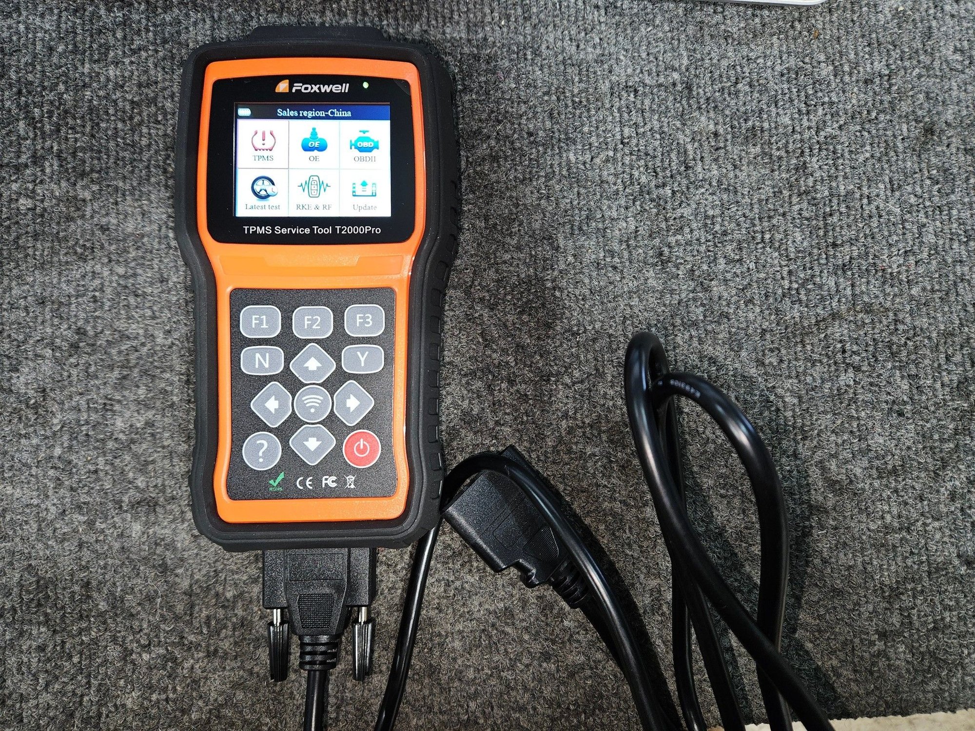

I had new tires new tires with new TPMS sensors (bought from Amazon) installed at Discount Tire last November. Although they installed the sensors, they couldn't (wouldn't?) program them.
So, I decided to buy this Fowell T2000Pro TPMS programming tool - it rocks!
I used it to finally program those new sensors on the Z, and then I was also able to program new sensors (with new tires) I had put on my new-to-me 2010 Scion xB commuter car. The tool was $135 thru AliExpress. It supports WiFi SW updates and easily read my new sensors and programmed them thru the OBD port without an issue. Previously for the Z, I had used the manual re-learn procedure (details here) which worked well, but using the programming tool got the job done in the driveway and in less than 10min.
I've had good luck with another Foxwell diagnostic tool I loaded with SW for our Mini, Dodge truck and for GM, so I thought I'd give their TPMS tool a try - I heartily recommend it!
