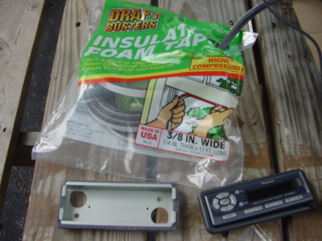

In addition to tips posted by Ft. Lauderdale (thanks!) - I want to add a few things. If you don't want to heat and bend the XM mount but still want to install below the ventilation ***** but in front of the shifter, install foam tape you can get at Walmart

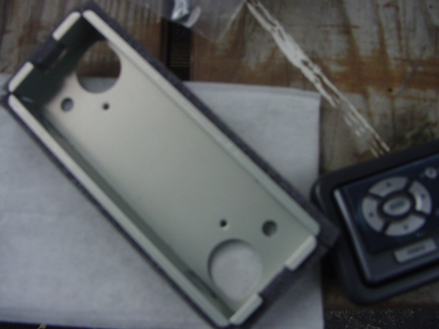

This is a closer but out of focus view - I trimmed the corners after this so they won't stick out after installation and advise you do the same

This foam is the exact color of the dash and will fill the gap caused by the curvature of the dash.
