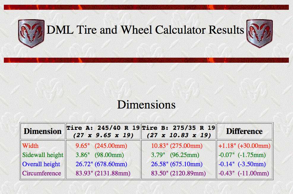

OEM tire size is a departure from the 350Z with the front tires taller than the rear. This will be interesting as 370Z members mix tires. We will see what combinations VDC will tolerate and which it will not.
