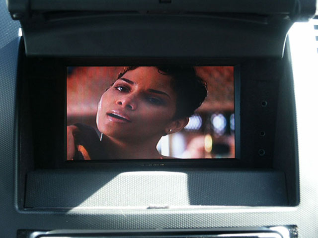

There are no screens that will fit inside the 04 nav compartment and be able to close the door, even with custom fabrication. Buy the 03 nav compartment and you can swap out the door and unscrew the back of it to mount the screen flush. The nice thing is that you can put it back to stock very easily. There are several screens that will fit in the 03 compartment, but its best to have it in your hands first then you can measure it.
I have an 04 touring, bought the 03 nav box and used a Sony H-65, it fits like a glove. Resist the tempation to buy the 7" Farenheight screen, they are not that good IMO.

You can install a LCD in a 04 but you would need to do some fabrication.
Az

I beg to differ.....Check this out...
http://www.350zmotoring.com/forums/s...threadid=20064

It appears I spoke too soon...Is the car in the thread I just posted yours? If so, you are the KING.......

FLZ... Thats my car. 2004 with a 2003 nav compartment. Sony H-65 monitor. No cutting or custom fabrication needed.

i thought he was talking about the car in the thread link.
mine is a 03 non-nav cubby hole in a 04 fitted with a Xenarc 7" touch-screen monitor

why would u put the sony when u can put the xenarc and not lose any screen space ? as u can see in the pic, the sony case sticks out like sore thumb, as opposed to the xenarc which sits flush
