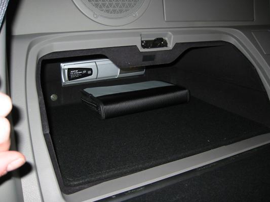

Or you could mount it like i did.

I got around to actually installing the thing. I had to notch the back of the speaker area to make room for the back of the CD to come thru just a bit. Good positive mounting is possible with the two tiny "L" brackets on either side of the CD player.
And the shot from the front - perfect fit.
