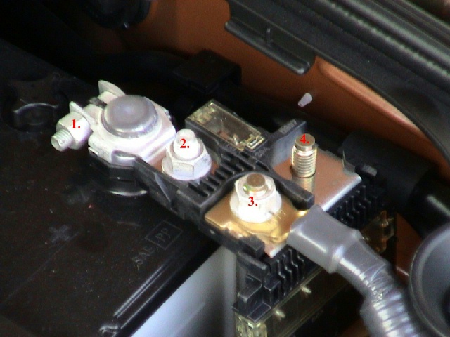

Just popped off the battery cover to get an idea of where the fuse folder is going to sit and then where the power cable will enter the firewall, then noticed that the OEM terminal going onto the + post of the battery has 4 bolts??
When looking directly down on the battery the bunch of them look like an "L" more or less...
O
O
O O
Which point did you connect your power cable to?

quick pic I took
Attached Thumbnails 4 Positive "+" Terminals? Which One Did You Use????-battery_post.jpg

Use 1 or 2. If you take the plastic from around the batt. cover you will have a gromet staring you in the face.

how come not 4?

By the looks of it 4 is after the factory fuse for the batt. If hes running 1/0 gauge then he must be planning to pull alot of power that doesnt need to run through that fuse. I hope hes using stinger 1/0.

ooooohhhh - 4 gauge sounds right assuming you amp doesn't pull over 100amps.
To the original question, I used post 3 for my stereo install mostly to keep everything clean looking.

It you use 3 your running it through the factory fuse. If you ever have a problem (pinched wire, bad amp, etc.) You could make your car not able to start, run, etc. If your worried about looks pop off on some nice stinger batt. terminals. If you got enough money to afford a Z you should have enough for batt. term. If you want a good deal on some PM me.
