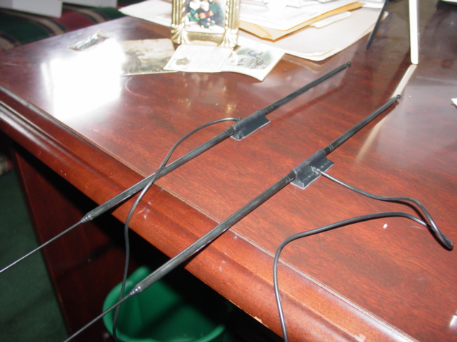

A little while ago, I installed a TV tuner onto my in Z-PC. I also got an amplified dual antenna. Overall, the quality of the reception is pretty lame even with the antenna. It varies on where I am and the surrounding terrain but it has NEVER been really great. I live about 20 miles from the 3 UHF stations in Youngstown, Ohio. The nearest VHF channels are Pittsburgh and Cleveland and there is NO WAY I'm pulling those it!

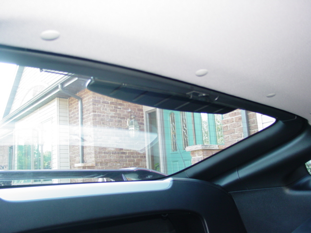

The tuner software installed without much difficultly on my PC and the hardware wasn't too tough to install either. I spliced the power into the rear cig. lighter. The antenna is stuck to the black plastic just in front of the rear window. It is 100% stealth. You can't see it at all from the outside and it is hard to see even from the inside.

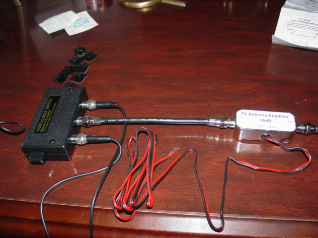

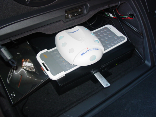

There are two antennas and you can switch from one to the other with an A/B switch that really doesn't help much so I just buried the second antenna under the mat in the rear. The A/B is behind my PC in the glovebox so it is impractical anyway. The TV tuner is also in the glovebox.
Here are some pics:
Antenna

The amp and switch box:

Antenna from the inside:

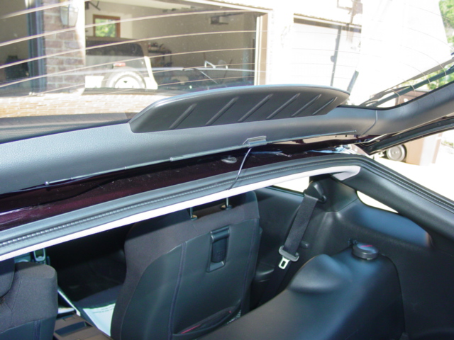

Antenna from the outside. I ran the wire under the headliner and down the B pillar and into the glove box. Completely hidden.

TV tuner:

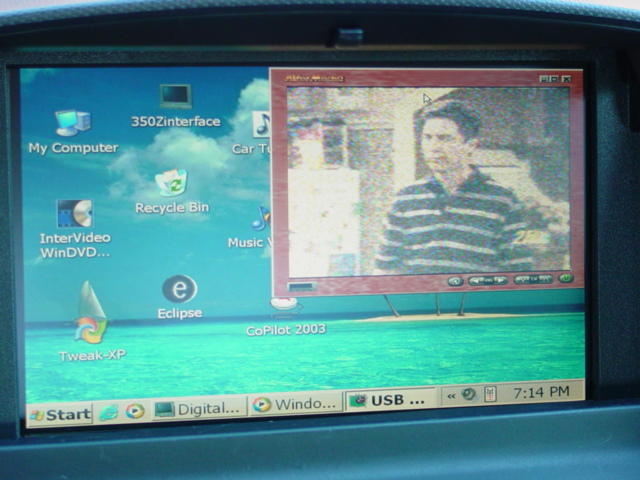

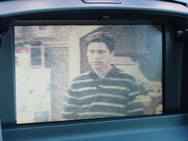

The picture (small):

Full Screen:

The reception is a lot better when I drive over to my Ohio office as I am then only about 7-8 miles from the TV stations but even then it isn't great.

With the two antennae on a larger car (where you could actually use both) it might be better.
The sound was another problem. Since the PC doesn't have a sound card, I couldn't get sound simply using the USB. I get vieo that way, but no audio. I had to instead go from the audio out jack from the tuner into the PC audio in jack. I needed a splitter since this jack was already being used to go to my FM modulator for the PC.
It sounds OK after all that but you hear the static just like you see it unfortunately. You could hear a game or the news or whatever I'm sure though.
