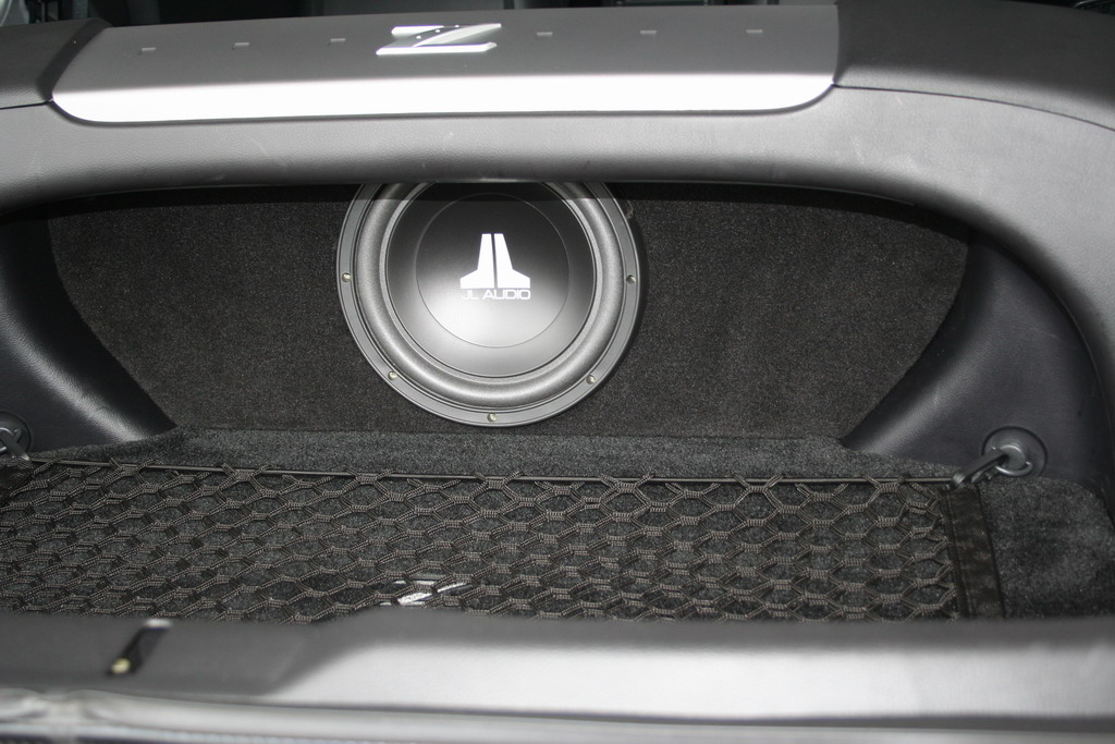

I have Mike at Zenclosures S-Type. Love it. Leaves lots of room.
Attached Thumbnails Box placement questions, Which would be better?-img_0034.jpg

below is the box i am using currently
3/4 " trupan
1.5" baffle
31" x 19" x 14.5"
2 x 4" aero ports
tuned at 35 hertz
B.J. Fisher Custom
and driver is a Digital Design 9515G 15" DVC 1 ohm with carbon fiber dust cap
here is my hatch with an old box and RD Driver i was using , but swapped it out for the one above
