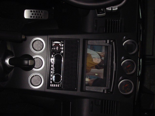

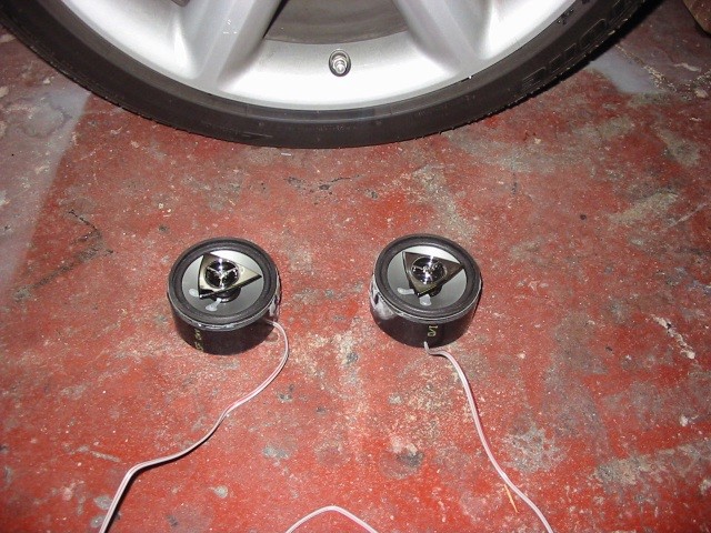

I used 2 3 1/2 rockford coax. I mounted them in small pvc enclosures, and then buit ABS horns on them to bring them to a DIN size and brought it out above the radio.
Attached Thumbnails Anyone know of a center channel speaker not amplified-centers.jpg

pics if grill.
