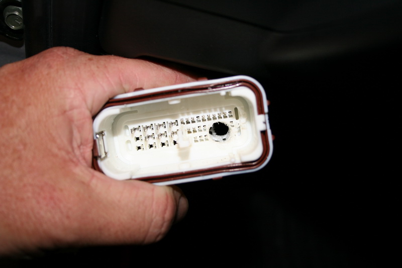

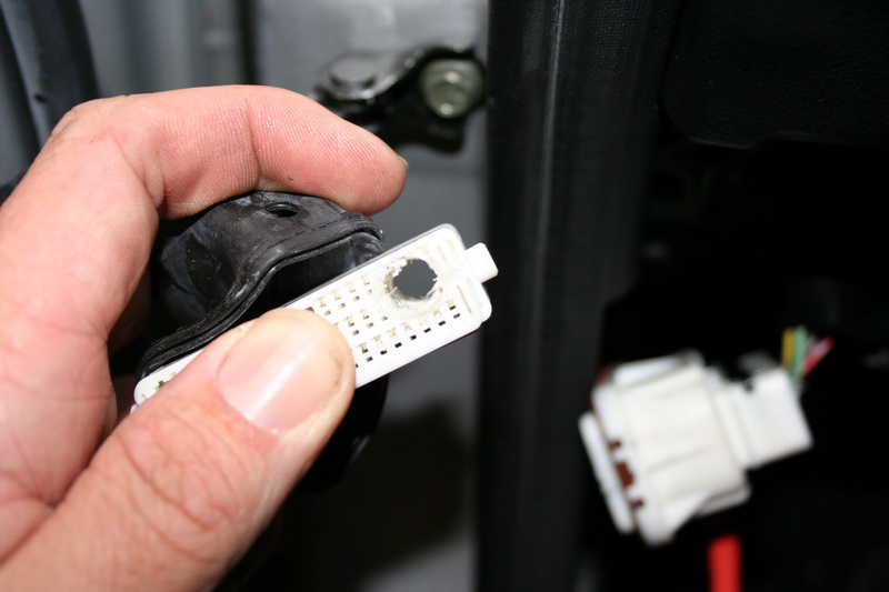

Just drill the molex. It's not that hard. Makes for a clean install.
Attached Thumbnails Run Speaker Wire: Alternatives to Molex and stock wiring-molex_1.jpg   Run Speaker Wire: Alternatives to Molex and stock wiring-molex_2.jpg

back to the original topic. i agree if yo uwant to run wires into the door, just do it through the molex. the alternative method is no easier, involves more drilling and creates more of a chance of water leaking into the car. if you are uncomfortable doing it yourself, i would suggest finding someone who has done it before or a shop

I drilled the out the molex a few weeks ago for my install and ran all new wire. But be carefull! I nicked a wire and shorted out my passenger side window. It took my dealer 4 hours to track down the short. One other note on drilling the molex. They come apart easy but getting them back together is a PITA. I had to take my doors off the car so that I could close the clamp. There simply was not room for the clamp to close correctly with the door on. Maybe it is just an issue with the 2006 model. My dealer said that they also need to remove the door on the 2006 to close the Molex clamps.
