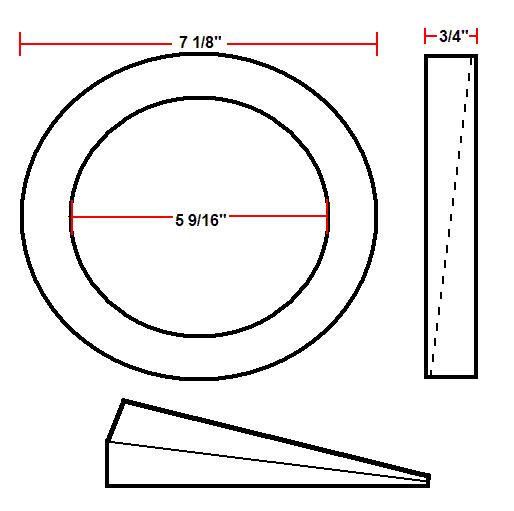

You mean like this?
This template is specific for MB Quart PCE-216, but the concept is similar for most other 6.5" speakers.

That is exactly what my installer did, but he used a plastic spacer and just ground it down to that angle. It worked great, with room to spare.

Exactly ,but I highly recommend wood over plastic and dont forget to sealed them up after. also drill more holes (1/8') thru the OEM speaker grill.
