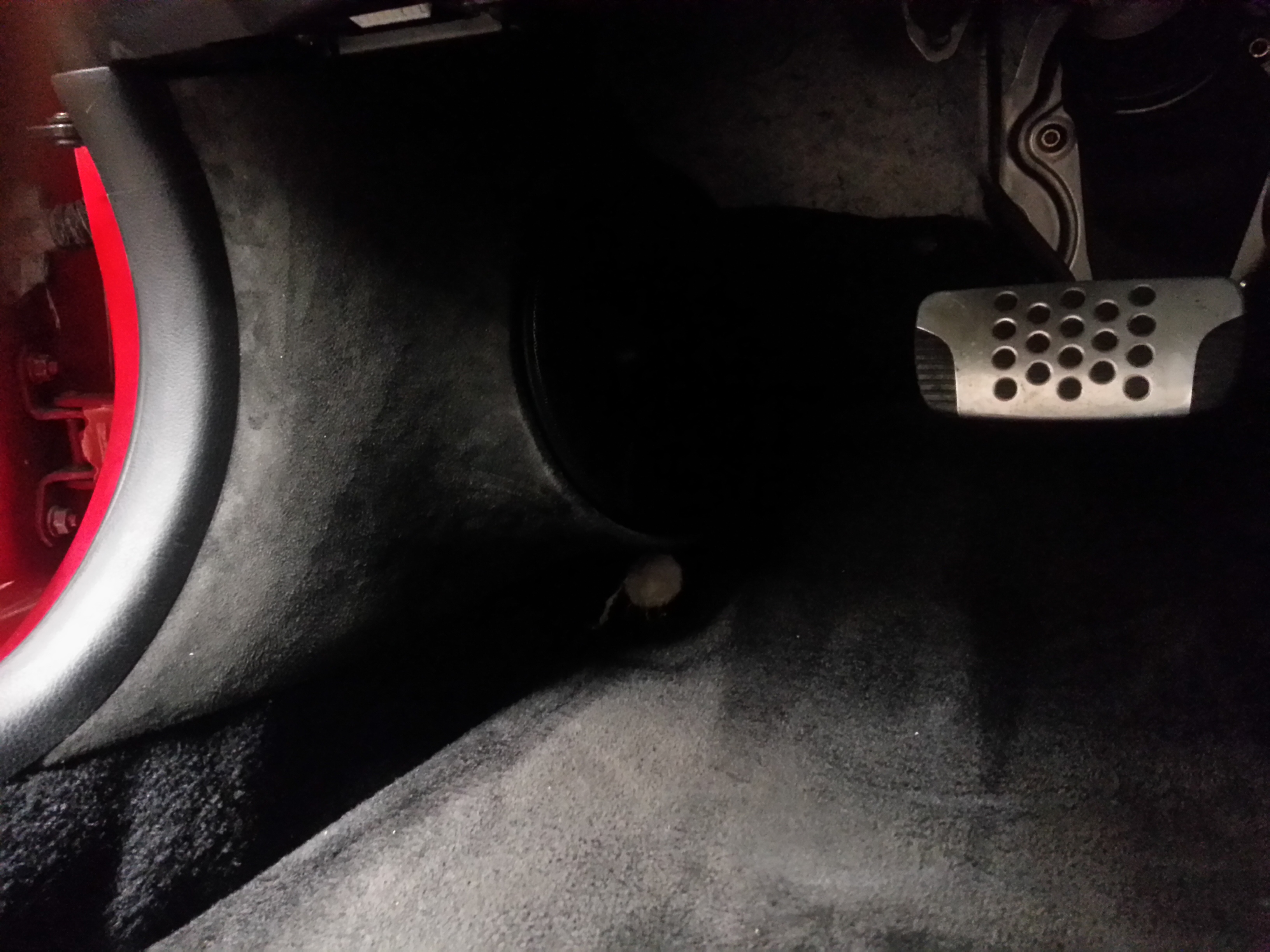

Originally Posted by jdmfetish
I'm curious, where'd you get the delete button for the dead pedal? I like it, it looks clean.
Also, did SimplicityinSound do your kick panels by chance?
Old Jul 12, 2017 | 07:01 AM
jdmfetish's Avatar
jdmfetish
Joined: Jan 2014
Posts: 925
Likes: 125
From: USA
Yes, Bing did my kick Panels , and my A-pillars .
When the Dead Pedal is removed you simply have 2 Bolts sticking up thru the carpet.
I had a few of these laying around and simply got lucky.
http://www.rockler.com/screw-cap-cov...quare-x-screws
Are you me?
Thanks!
Attached Thumbnails Installing a forward firing 12" IDMAX subwoofer behind seat-20160924_213415_lls.jpg   Installing a forward firing 12" IDMAX subwoofer behind seat-20160924_170742.jpg   Installing a forward firing 12" IDMAX subwoofer behind seat-3.jpg
