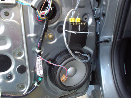

zachcrosen is correct. Here's a pic of kappa 60.5cs installed with the factory speaker as spacer:

Thank you! Great info! Just what I was looking for. I love this comunity! BTW- Have my Basslink, ordered my doors/rears today. New Alpine deck on order (One of the new ones with 512 display colors to match your dash. $439 Crutchfield).
