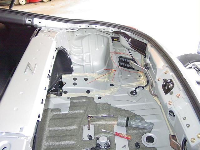

Does anyone know what this vent is for? There is one on each side.

Old Apr 12, 2004 | 10:50 AM
aalzuhair's Avatar
aalzuhair
Posts: 1,295
From: Riyadh, SA
So the car does not whistle when in high speed, IMO
Az
Old Apr 12, 2004 | 11:20 AM
Big Sexz's Avatar
Big Sexz
Posts: 484
From: here and there
My vote goes towards being abe to close the doors easier. If the car was airtight, the doors would be VERY hard to close completely. Think of it as an air pressure equalizer. Have fun matting, I just got finished. If your using scissors to cut the stuff with I recommend spraying them with some Pam. Trust me, it will help.
Old Apr 12, 2004 | 11:45 AM
sparky3Z's Avatar
sparky3Z
Posts: 197
From: Tallahassee, FL
I think the vents are for normal air flow through the interior. When your AC/heat fan is running and pulling air from the outside, it has to exhaust somewhere.
Old Apr 12, 2004 | 12:41 PM
240DRIVEN's Avatar
240DRIVEN
Posts: 45
From: MA
I think your right about the pressure equalizer. Makes sense.
Old Apr 12, 2004 | 12:55 PM
TeesZ's Avatar
TeesZ
Posts: 67
From: AZ
But thats why the windows roll down 1/2 inch when the door is open...isn't it?!?
Old Apr 12, 2004 | 06:47 PM
bshockley's Avatar
bshockley
Posts: 219
From: Duluth, MN
I think the rolling down is more so that you don't wear the seal everytime you open/cloe the door. By lowering it is free of the small lip that it fits up into.

Old Apr 13, 2004 | 06:40 PM
fresno350's Avatar
fresno350
Posts: 571
From: Al Anbar Province, Iraq
when you vent fresh air it exits there....when you use the re-circulation on your air it closes it
Old Apr 14, 2004 | 05:34 AM
FLY BY Z's Avatar
FLY BY Z
Posts: 2,700
From: Maryland
no. they are just flaps and they bounce open and closed as you drive and make an awful tapping sound that is audible when you have the interior in the rear stripped. they are not that scientific.

Old Apr 16, 2004 | 12:14 PM
cal_z's Avatar
cal_z
Posts: 299
From: paducah, kentucky usa
O.k., the vents are for relief of air pressure inside the cabin. The windows notch up to ensure a proper seal when the door is closed. The drop when opening is for clearing the frame
of the door.
