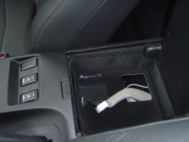

Wheres the other end of this cable?

OK - the pre-wiring is done in the factory in Japan...
If you open the Briefcase box, behind your passenger seat, you'll find it has a false bottom. Underneath the lay in base is the control box for the phone wiring, I believe...
Obviously you will need one of the Nissan encoded THBury cradles & you already have the controls on your steering wheel & the microphone & aerial pre-installed above the rear view mirror.
Hope that helps
Old Apr 25, 2004 | 01:21 PM
birkler's Avatar
birkler
Posts: 11
From: Sweden
Thanks man.
Under the false bottom there was an compartment for the manual. Lifteing it up revealed what indeed appears to be the correct connectors. Thanks. Further invistigation can proceed...
