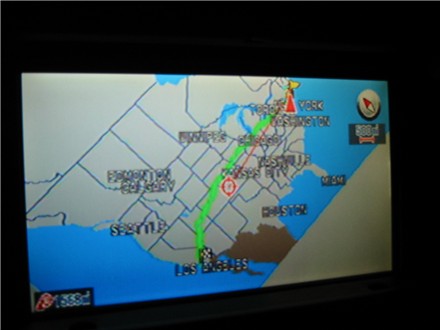

Here's a map of the route for me to go from Hamden, CT to Rancho Palos Verdes, CA, my hometown.

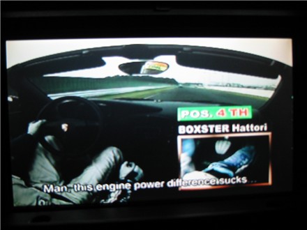

Here's a funny pic of the Best Motoring video in action. If you don't have this, I seriously suggest you go get it.
The way these guys drive is just amazing.
By the way, he's driving a Boxster. And he's in last place.
Attached Thumbnails Pioneer Nav System Finally Installed!-engine-power-diff.jpg
