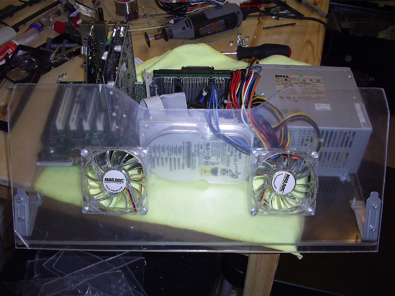

I started off with this old Dell I had from back in 2000. 700mhz Pentium 3 old, that doesn't work. I tinker and tinker and get it to work. So I put together a plexiglass frame, throw in some fans and pick up a Lilliput 7" wide touch screen.
Power: I'm really low budget at this point so I just use power inverter and the regular power source. This is kind of a ghetto way to do this, but as I said, low budget. What I should (and later do) use is a direct DC-DC converter made just for computers in a 12v environment.

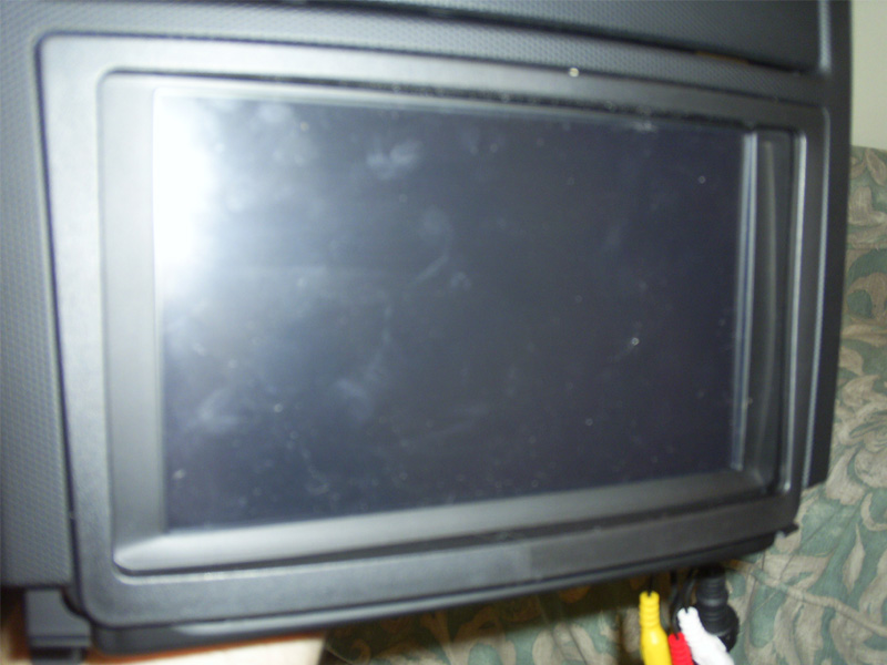

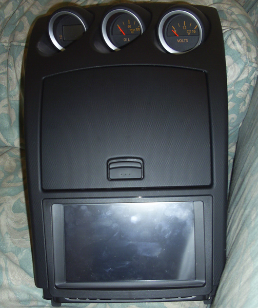

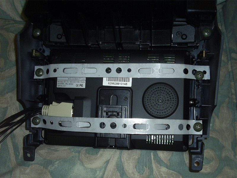

My first choice for the location was, naturally, in my empty nav pocket. Now I worked in car audio for some time recently and I feel I am a pretty crafty guy. But I could not get the monitor to fit in the pocket above the radio to my liking. Wanting to keep the door, and keep it operational and also didn't care for the reach, I sit all the way back, I decided to just go all the way and get rid of the radio. So I used a double din radio frame and some backstrap and just my luck, it fit like a damn glove. Check it out....

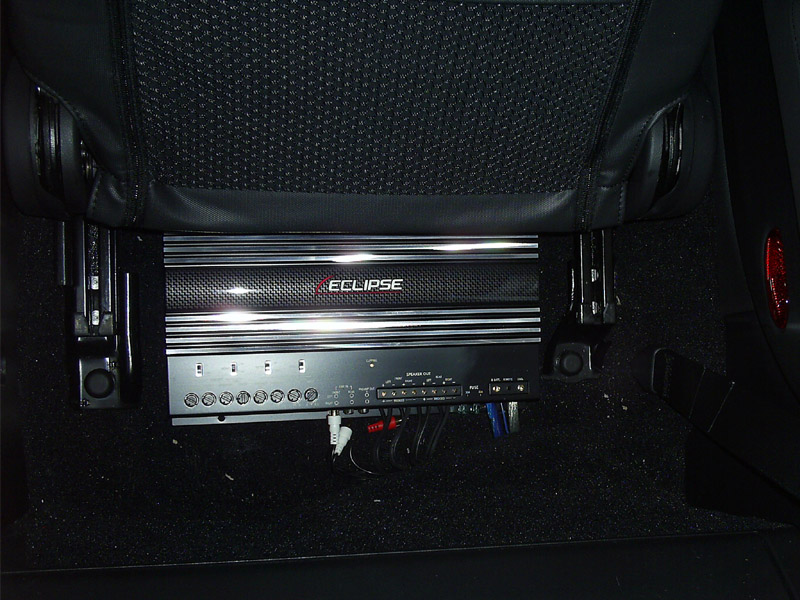

So you are probably wondering how I get sound. Funny enough, a sound card hooked directly into a 4 channel amp sounds pretty good. Especially considering how old the card is, it works ok. New computer and surround card are coming, thus the 2 loose RCA cables not being used for now. The Z is great, tons of room under the seats. This one is under the passenger side. The sub amp will go under my big ol' butt.
So here are the shots of the stuff in the car.

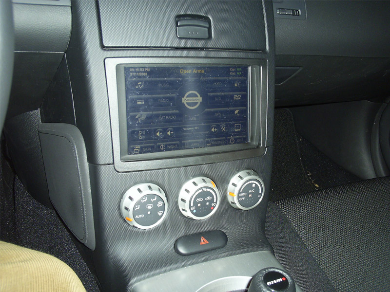

Here is a good one from the center showing the Nav: MS Streets and trips

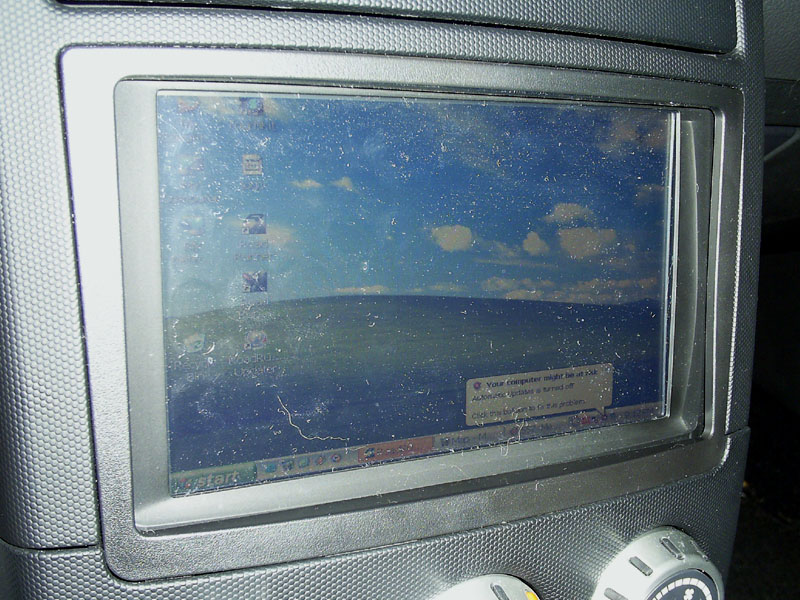

And an extreme close up of the desktop.....
Those with a strong attention to detail will notice the lower center console doesn't sit quite flush with the upper portion covering the screen. This was due to the presence of the screen. I trimmed the feelers under the lower portion and it fits great now.

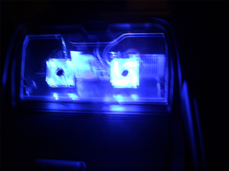

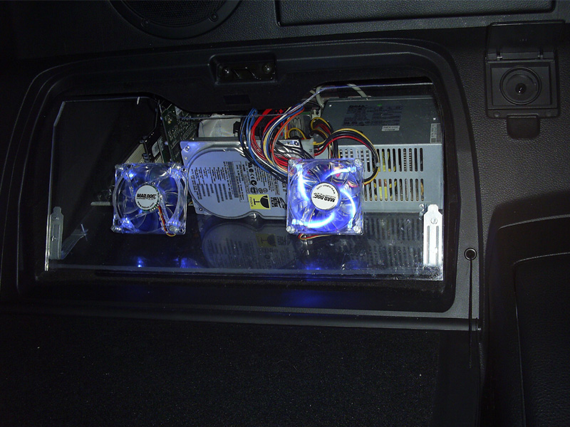

I think this part is the coolest. It looks like crap on the bench with the plastic covering on the plexi. In the car, the template I made really paid off, cause it fits like a glove. The fans are blowing in opposite directions so it creates pretty good circulation. And because I cut out the back of the glove box area, cool air from inside the chassis is alowed to circulate. Haven't overheated yet.
This is with the lights on and the fans spinning. You can see on the right the button switch I used to power on the inverter, which incidentally turns on the computer also.
Carputer Install pics.  350Z is the Best!-case-20in-20car-20and-20switch11.jpg
Here are some with the lights off, and the blue fans kickin'!! Again, sorry for the poor quality. I held it really still but it still came out blurry.
Carputer Install pics.  350Z is the Best!-case-20in-20car-20blue-20light12.jpg
Carputer Install pics.  350Z is the Best!-case-20in-20car-20blue-20light-20cu13.jpg
It was a real pain to have to turn the thing on and off everytime I got in the car. That is why I have the dc-dc with shut-down controller now. And even though it is only 700 mhz, it only really needs to run winamp and MS streets and trips.
My Carputer round two is next.
