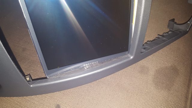

Once the tablet is done being test-fit, it can now be installed onto the console permanently.
1. Setup the tablet in the desired location on the console.
2. Use Sugru putty to secure tablet onto console. Wait overnight for Sugru to dry.
3. Test fit console/tablet assembly onto dash. Use dremel to trim off any plastics that get in the way. The tablet I used for this guide required me to only cut out a small piece of plastic which was rubbing onto the USB connector.
4. Plug USB cable into tablet before permanently reinstalling console/tablet. Also reconnect gauge harness.
5. Carefully reinstall console/tablet. Make sure there are no gaps and that everything is correctly lined up.
6. Turn on car and enjoy :]
