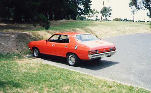

My first car the XC, it was a piece of junk, but indestructable. Mine had so much rust in it I could never got lost, I just followed the trail of iron oxide flakes home. Another advantage was that you could r**t on the back seat without being a contortionist!
Ah! Summer nights at the drive-in. Jeez I feel old all of a sudden...
