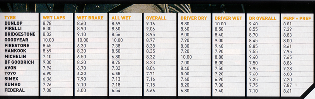

KY350 now you can use your rating scale against these tyres.
The charts are ranked from best to worse, top to bottom. If any one wants what they said about any of the tyres let me know.

Murray - I presume that the higher the number the better?

Yep thats right higher is better and the list in ranked as well, with the better at the top. And no you have the touring model which doesnt have VDC, so you dont have to worry about those things like the others do.

The tyre tests are very handy for seeing how the tyres perfrorm .... but you need to remember that tyre performance is not only dependant on the tyre itself, but also the actual car. Afterall, some tyres work better on some cars than others, and vice versa. What works well on a softly sprong sedan will not necessarily work on a lighweight, stiff sport-car. What works on a FWD, will not necesarilly work the same on a RWD etc. Also, none of them will tell you how good the tyre will be when it has 10,000km on it, but only when new.
So what you need to do it take a look at the car that is being used, and see how that applies to you (or the car that you're trying to cater for). Though, that does not mean that a tyre that works on a car A, will not work on car B.
Also, don't get too swept up in the 'order' of results listed by Motor/Wheels. They do not use a progressive scale, and also they themselves are the 1st people to say that it's hard to get 100% clynical data and that there is some variance. What that means is that list all the tyres that seem to have 'close to best' results in at the categories important to you, and all of those should be a 'solid' perfoming tyre.

Im assuming your grading on performance and I'd disagree with some of those choices. The S02s are the older model tyre and the S03 is Bridgestones new ultra high performance tyre.
Even in the test above they noted that the S03 were close behind the Pirelli in both wet and dry handling with the S03s better in wet braking. The dry track tester like them better than both the ones which ranked ahead of it overall. And the wet tester ranks it very close behind the Pirellis.
Yes, they are a good tyre ... but relying on one tyre test on one particular car is not enough. Speak to the people who had both ... in particualar on the track.
One more thing ... the P-Zero here is the "Nero" ... that's the bottom of the range P-Zero tyre. P-Zero is becoming a 'brand', not unlike "Potenza". The P-Zero "Roso" and "Giallo" are the P-Zero 'performance tyres'. From what I remember the "Nero" is a more a mainstream, comfortable and longer wearing version of those. Hence not as perfromance oriented and more directed at sedans than all out sports cars. Also it's cheaper than the othe rP-Zeros.
