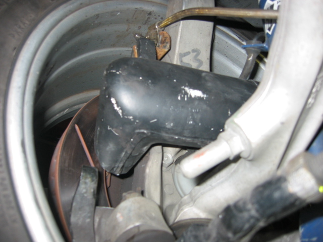

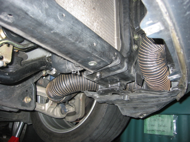

Thanks for the duct ends. I finally got around to finishing the installation. Thanks to CRayZ for the install tips. I had excellent results at thunderhill this last weekend. I made a few changes for my installation. First, my hose does not do the u-turn that yours does in your above picture. I removed that plastic piece on the passenger side and routed the hose in a straighter fashion to the wheel.
Second, I trimmed the fiberglass duct end by about 1" to give some more clearance with the hose and my 9.5" wheel at full lock.
It was a cold weekend but from what I could tell, I was running a little cooler up front. I just have to go back in some time and tidy things up and seal the ends with some RTV.
I'll post some pics when I have a chance.

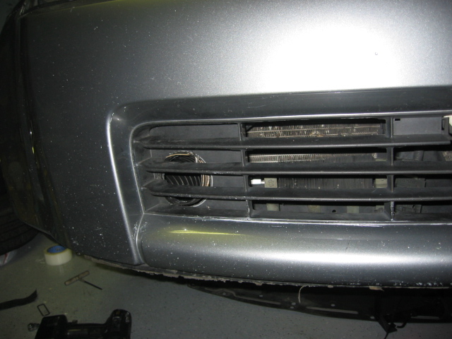

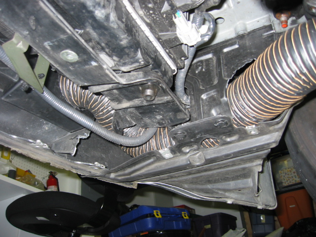

Pics before tidying things up. After pics will come in about a year when I tidy things up.

Looks good. I like the way you routed your hose. It looks like it will not rub with full steering lock.
