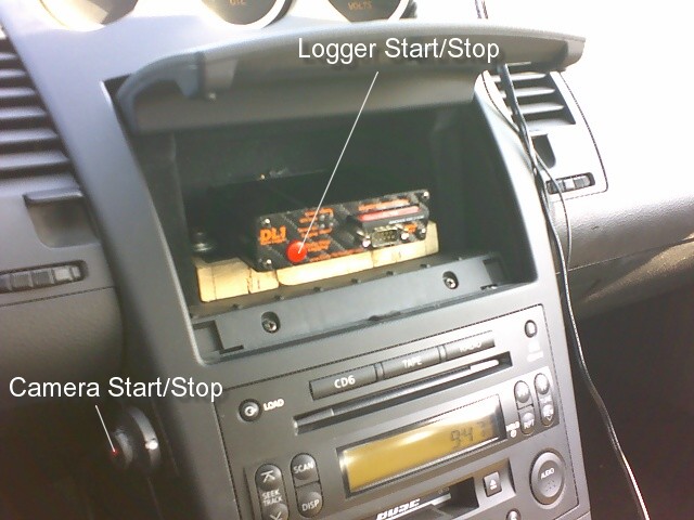

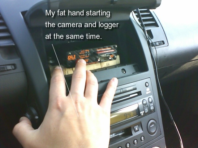

Default DL1 Mounted
Enjoy. Picture of the DL1 mounted in the nav cubby and LANC controller for the camera. Like I said, the cubby door closes with the logger in operation. I strung the antenna, power, and RPM wires through the holes in the back of the cubby box. Super clean, I love it.
Kolia, if you're interested I'll post the DL1 RPM signal procedure and circuitry I used...you can actually see the components sticking up behind the logger. I just soldered some component leads together then crammed them in the screw-block connector. Not permanent, but got it working.
uwaeve
