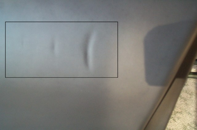

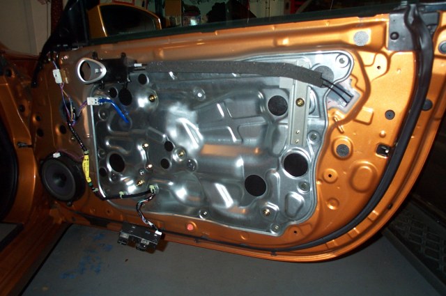

Here is a pic of the door panel (taken off the car; the dark part to the right is just a shadow) and the "naked" door.

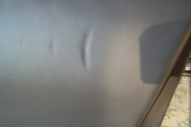

You can see from the 3 indentations on the door panel that is the range with the seat all the way forward and all the way back. All indentations would be the same size if I had left the seat in that position and the door closed over night. Those indentations are perminant as the door panel seems to be made out of plastic when looking at it from the back-side.

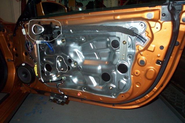

I circled the two bolts I thought I could use if I could get a thin bracket fabricated to hold the window controls to the naked door.
The latch area though would require more intricate fab work (even more dollars spent) to make a bracket that would make that whole mechanism more sturdy (and feel like you aren't going to rip it off the door when you try to open it from the inside).
The driver side controls are even longer and I haven't even looked at what might be able to be done there. Right now I am leaning towards cutting holes in the door panels and trying my hand at creating a fiberglass insert to hide the guts of the door while still giving me the clearence I need.

I personally still have my door panels in the car, but I have seen one car at the track that had the panels removed. His solution to your problem was very simple. He just took some strap metal and formed it around the door handle box and the window control box and got some short, self tapping screws and fastened it all to the bare metal. It will take maybe 5 min and cost under $5
