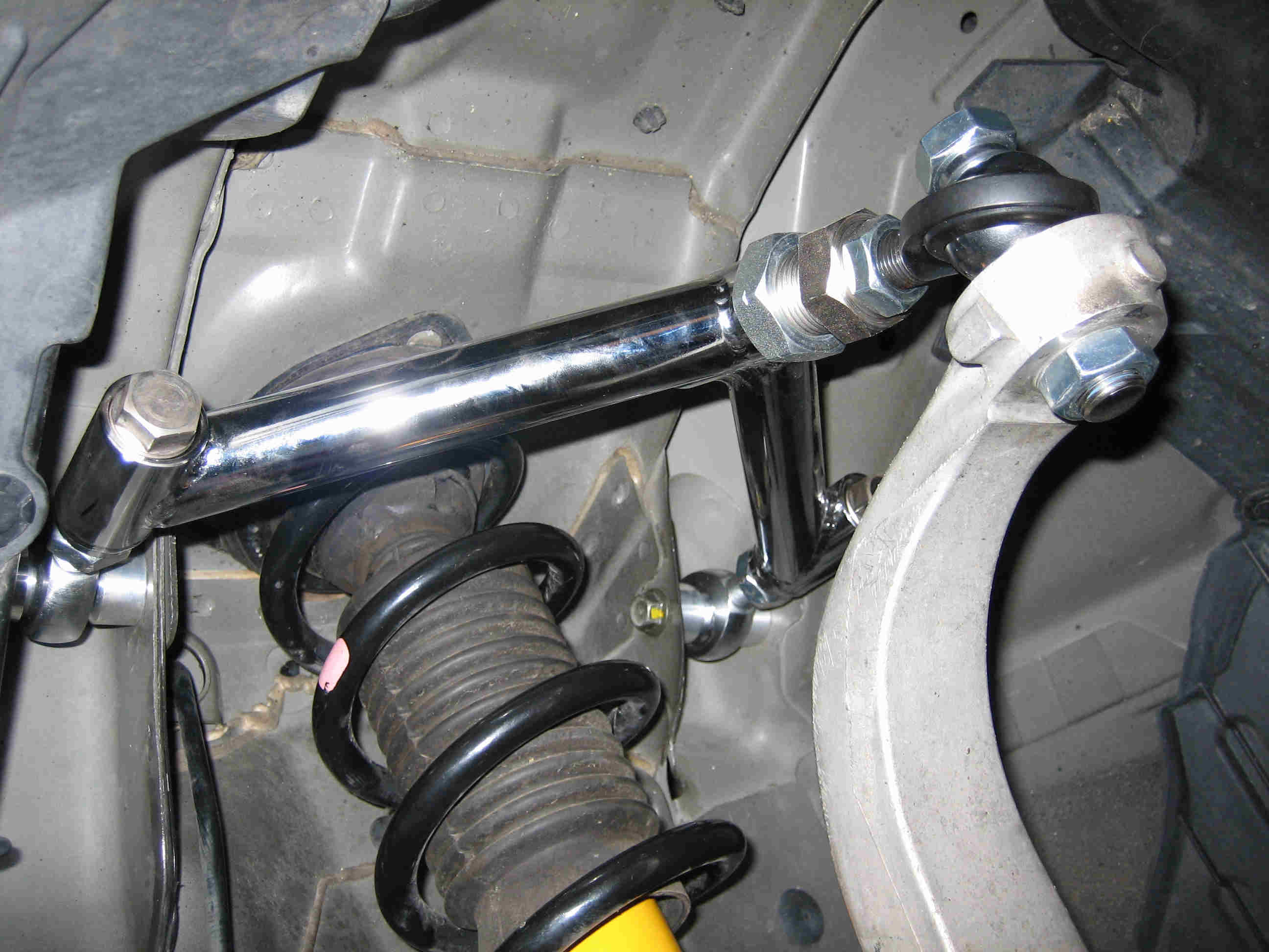

SPL arms are on the car now.
These things have zero play. Steel bushings everywhere...
Alignement is schedualed for Thursday. I'm basing it on values from those John @ BetaMotorsport posted in an other topic, with less street camber.
FRONT
Camber -1.0 (Going to -3.0 at the track)
Caster +9
Toe 1/16" out
REAR
Camber -1.5
Toe 1/16" in
Unfortunatelly, I'm not sure what's going to happen exactly to the front TOE when I go from -1 to -3 camber at the track. I'll see how it feels.
Any comments on those numbers ?

You'll have to check and most likely adjust toe when you adjust camber. Try to keep it at 1/16" out total for now. As you get comfortable with the new arms and the camber they give you, try upping toe out to 1/8" total.
