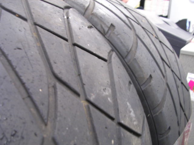

Cut the rear dust shield, that helped a lot in getting me more rear pad life. I just did the mod, my pads were getting 50-100 miles longer.
Azenis is hazardous compare to a set of R compounds. You might be happy with the Azenis now, but you will be even happier with a set of R compounds. Also surprisingly, I can tell you I get the same amount of miles between the RA-1 and the Azenis because I spin and slide the RA1s a lot less. I have both tires downstairs to prove it.
Attached is a pair of Azenis with about 10K miles on it
