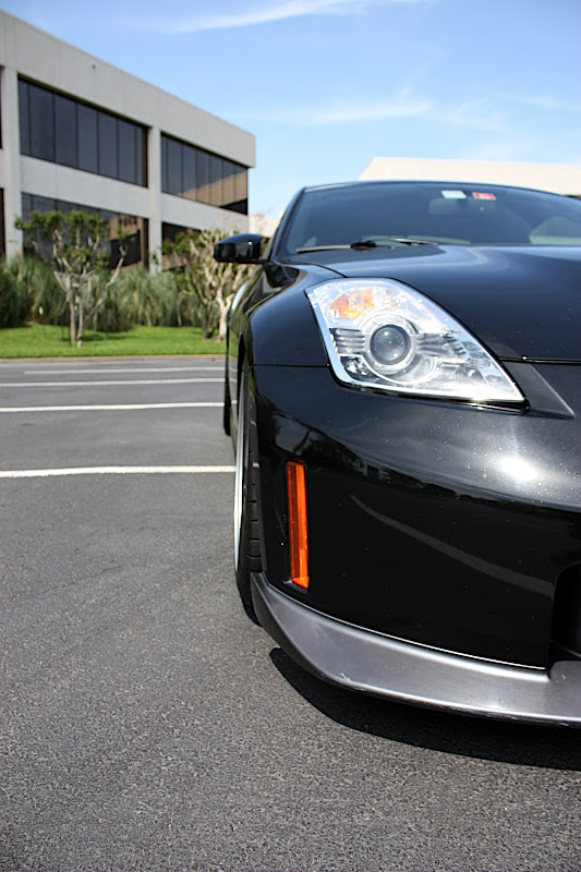

this is how it does fit a 255/40R17 front on a 17*9.5+18 RPF1 wheel with -3 degrees of camber and I'm quite low...

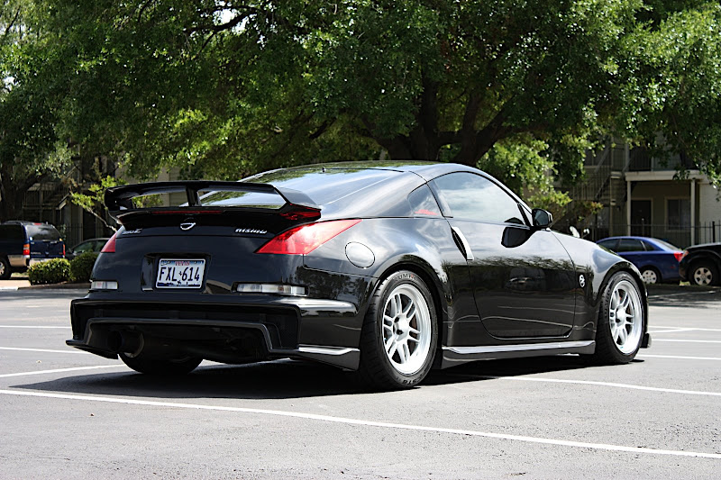

in the rear is a 275/40R17 still on RPF1 17*9.5+18 with -2.2 of camber
in the rear... no issue with rolled fenders I can stick a 285 but can't go too much lower with that camber in the front I had to raise it a little bit and put a little more camber to fit a 275.
